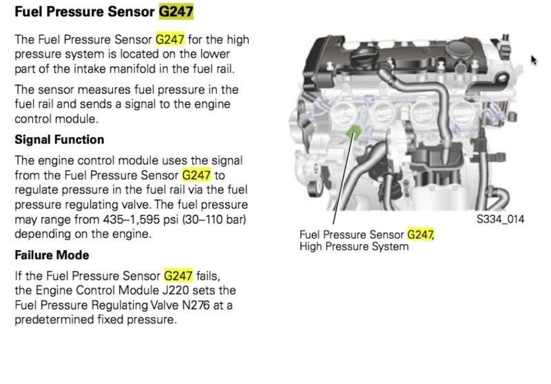

Is it in this picture?
Offline vRStu
  • -Given: 90
  • -Receive: 159
  • Posts: 2562
Re: Engine hunting and tickover low. Poor running in general. HELP!
« Reply #8 on: May 22, 2011, 08:41:48 pm »

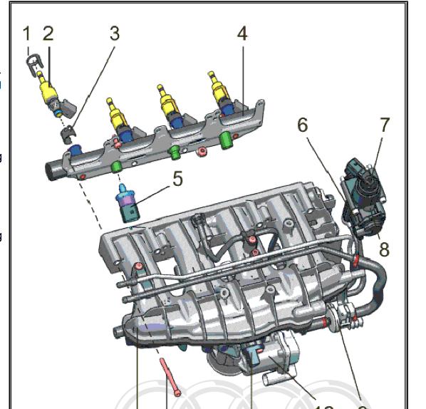

A loss of pressure in the rocker cover etc can cause hunting.  Often the filler cap or PCV are causes of this.
It would appear you need to investigate the fuel system.
Have a look here -
G247 is the one to the front left of the engine (and not on top of the fuel pump), item 5.
Stu...
