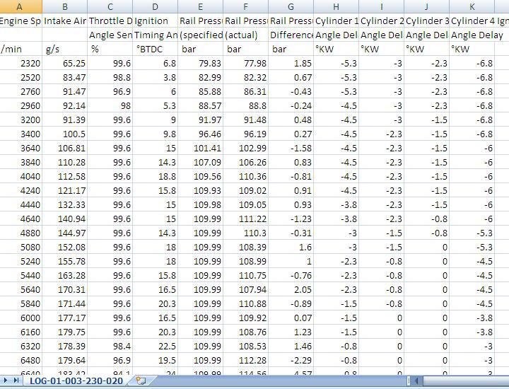

Talking about engine knock, mine is now running a stock map, timing pull peaks at 6.8 :scared: :scared: :scared:

 :scared: WTF is up with your car Dom.  Maybe its not the turbo then!!  Surely a turbo on its way out wouldnt cause timing pull.  is it possible to test the knock sensors,
can you email me this log please Dom
Thats what I would like to know, its booked in at the stealers on monday. Nearly traded it in for an S3 today, but the offered me less than I was expecting for mine :sad1:
Rob you have mail :wink:
