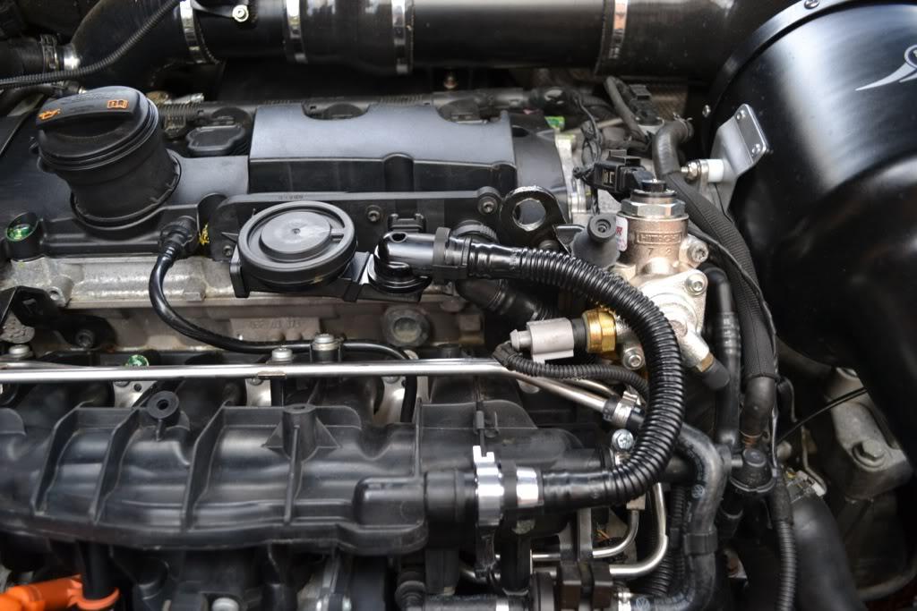

« Reply #515 on: September 03, 2011, 09:02:37 pm »
Couple more additions today
New Rev N PCV, mine was still on the original one from 2005 and was starting to idle a little rough, this has sorted that problem one.
Also couldn't believe the difference in the old vs. new PCV, the new one feels like it's twice as heavy and much better built than the original one, so VW do listen sometimes  :grin:
Also fitted the Draft 42 boost tap (thanks Keano  :happy2:) and linked it up to the PLX boost sensor ready for setting it up with my wifi OBD-II monitor on the iPad  :party:
And finally swapped the 225/40/18 Hankook RS2's tyres over to some 235/40/18 Dunlop Sport Maxx TT's, should give some much needed grip for the wet track days :driver: :driver:

How much is the new revision PCV?

« Reply #517 on: September 03, 2011, 09:12:09 pm »
£34 inc VAT  :happy2:
Re: SteveP's New Project
« Reply #518 on: September 03, 2011, 11:02:35 pm »
How easy is it to change the PCV?

« Reply #520 on: September 04, 2011, 07:23:50 am »
2 clip on pipes and 4 x T25 screws once you have got the engine cover off  :happy2:
« Reply #521 on: September 04, 2011, 08:14:01 am »
Sounds like the hardest bit. Unfortunately!  :sad1:
Wonder if it's worth doing for the sake of it. Anything else I need or do I just walk into VW with that part number?
