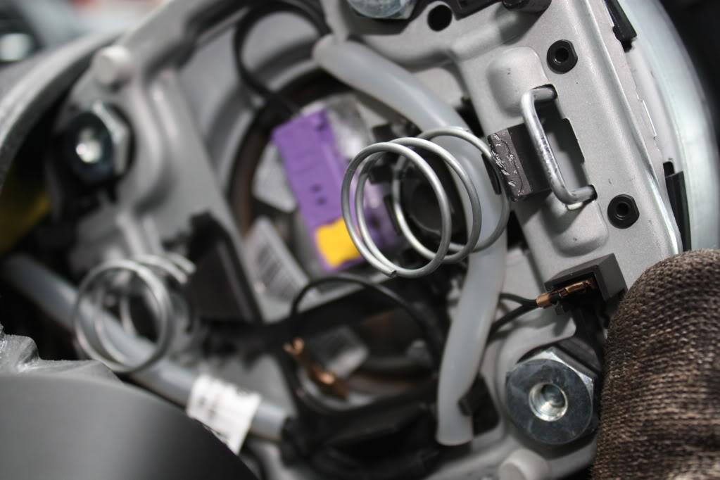

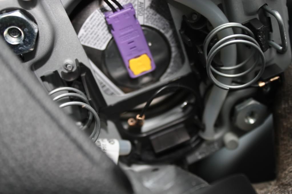

This afternoon I decided to try and fit my MFSW buttons. Taking all precautions I removed the airbag but I did not see what I had hoped. I understood it was a case of carefully removing the airbag and then simply plugging them in......not so, it seems :confused:
My car is an 06 manual and it seems like although I have both buttons and some sort of controller?? There doesn't appear to be a cable that connects them to the car?

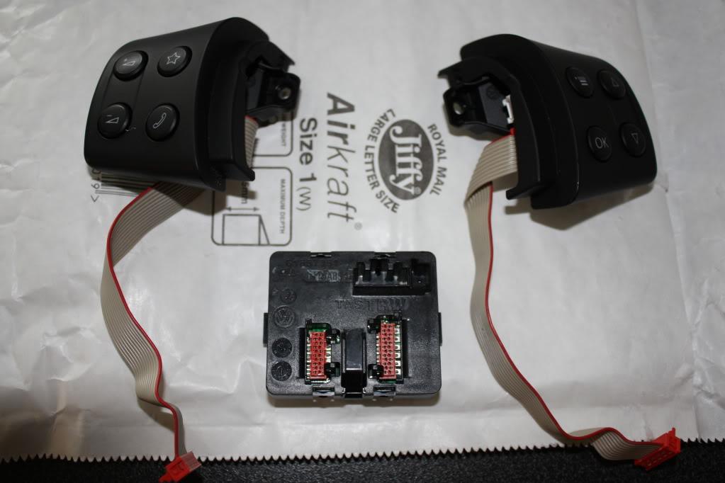

This is what I have (buttons came from an 07 car):
What am I missing?

Re: MFSW Parts missing? - Retrofitting MFSW Buttons
« Reply #1 on: May 28, 2011, 06:43:25 pm »
Pretty sure you're missing the airbag wiring loom for MFSW.
Stu...

« Reply #2 on: May 28, 2011, 06:49:20 pm »
Thanks Stu. I guessed it was something like that. So does this connect from the controller module (show in my first picture) to a point on the airbag?
I am not sure how this all fits together?? Will any coding be required?

« Reply #5 on: May 28, 2011, 07:21:30 pm »
Thanks given Stu. So if I understand this right I need a MFSW Airbag Loom part no = 1K0 971 584 C and I may need a new steering wheel control module ??
I have midline clocks but I thought all GTI's had highline steering wheel modules? :rolleye:
Supposing I don't need a new steering wheel module, I guess its a case of airbag off......fit buttons and new loom and then refit without any coding?
Thanks for your help.

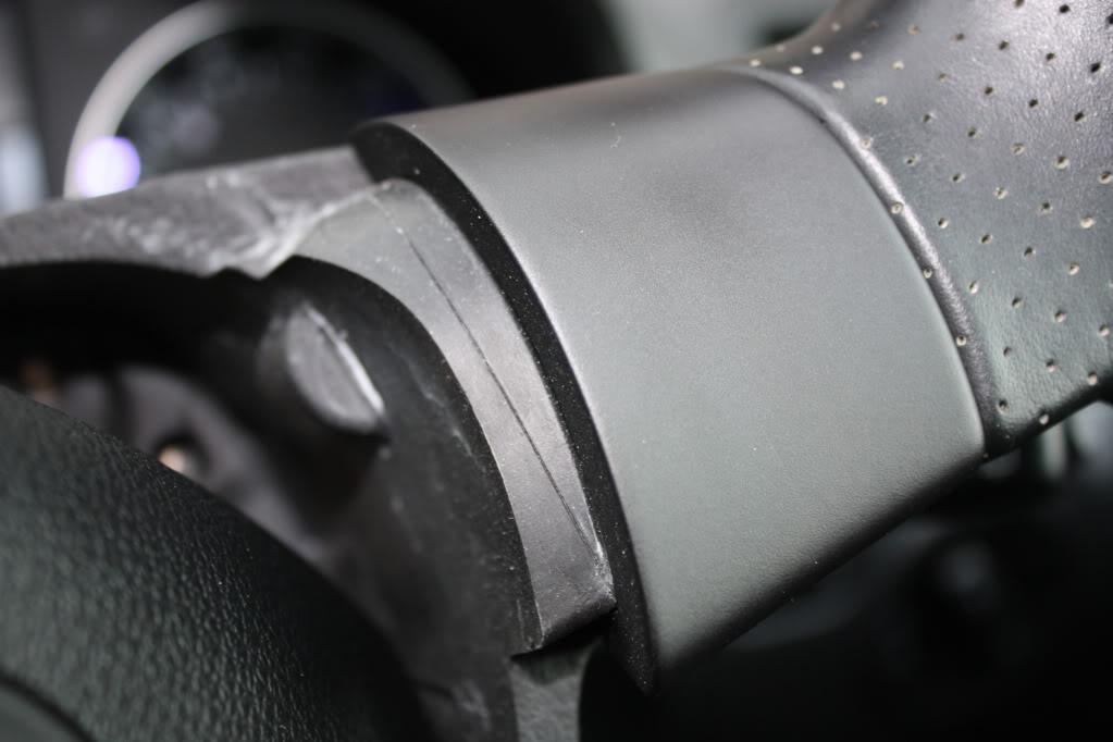

Stealth - I can't see any sockets to screw in the buttons on my wheel :confused:

« Reply #6 on: May 28, 2011, 07:24:12 pm »
I'd get the loom and fit it all up and see if it works before you go hunting for a Steering Controller.

« Reply #7 on: May 28, 2011, 07:25:07 pm »
You do need to screw the buttons to the wheel.

Can anyone confirm what Stealth is saying? I would hate to think I am wasting my time with this wheel. There does not seem to be a place to clip in the thing I keep calling a controller?
« Reply #10 on: May 28, 2011, 07:42:35 pm »
The DSG wheel has blank covers which come off and can be swapped with MFSW buttons.
I've been led to believe (by this forum!) that it cannot be done with a manual steering wheel.

« Reply #11 on: May 28, 2011, 07:47:50 pm »
stealth is right, unlike the VRS where I can see you had buttons just non functional.  In the Golf you cannot replace the black plastic blanks on the manual wheels as they are solid plastic.  if you get a wheel that has the cutt outs you will also need the airbag loom as stu has led you to believe.
