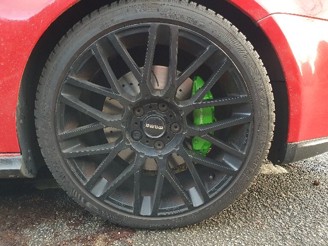

Front Boxster calipers fitted with HEL braided lines and Ferrodo ds2000 pads and some drilled and grooved discs.
I bought the calipers from the US of States as even including delivery it was still cheaper than getting a pair off ebay. I refurbished and sprayed them myself as I couldn't justify the cost of BCS or Bigg Redd doing them.

Hopefully this will show the newly fitted Boxster calipers

Still running 330mm discs? Did you have any issues with wheel clearance?

Stock discs are 312, which i've stuck with. I think I can go up to 330mm using Merc discs if I fit a spigot ring to account for the different centre bore.
Wheel clearance is fine. I did have the 18 inch Monzas when I bought the calipers and read on here that those wheels would also have cleared the new brakes.
