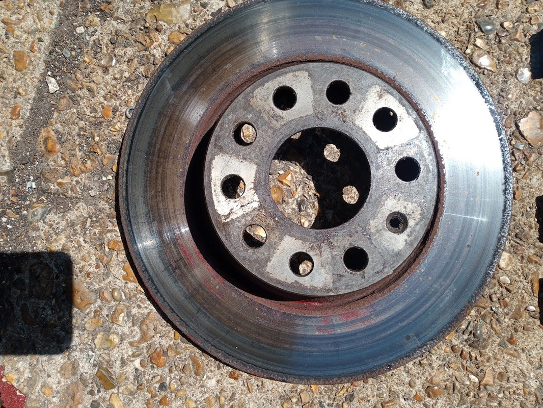

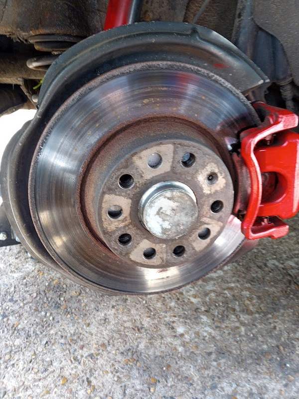

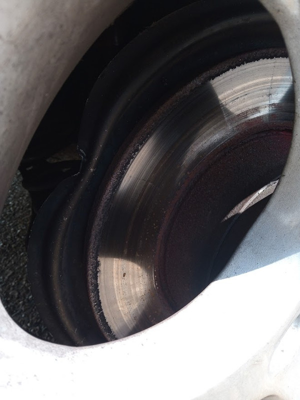

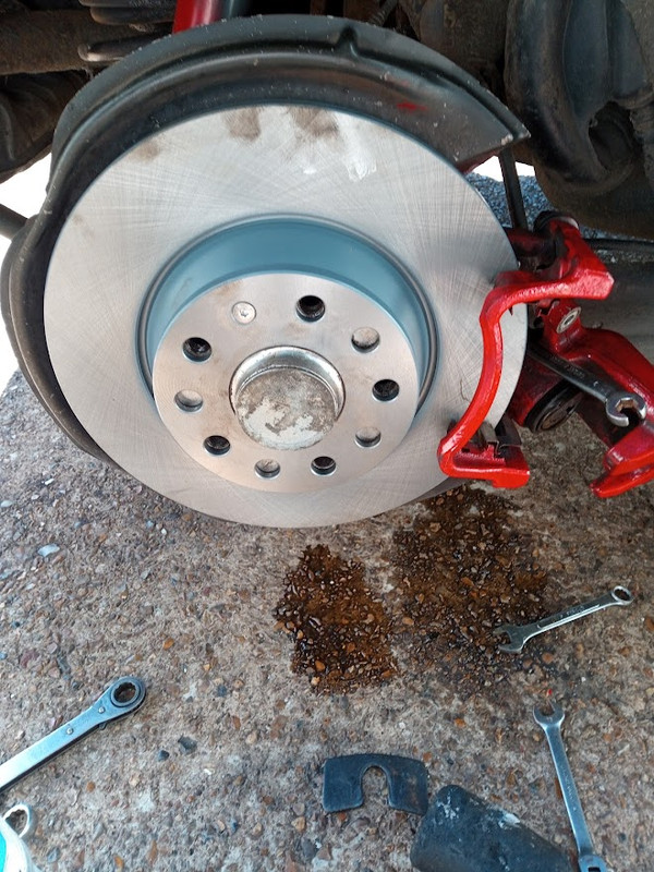

Finally managed to swap out both rear discs as I managed to pick up some Febi Bilstein rears delivered for £25.95 from Amazon, which is far better than the £45.95 I paid for th wrongly sized ones I had last weekend.  Used the blowtorch again and the spline bolt came out so much easier this time on the passenger side than the absolut ball ache th drivers side gave me.

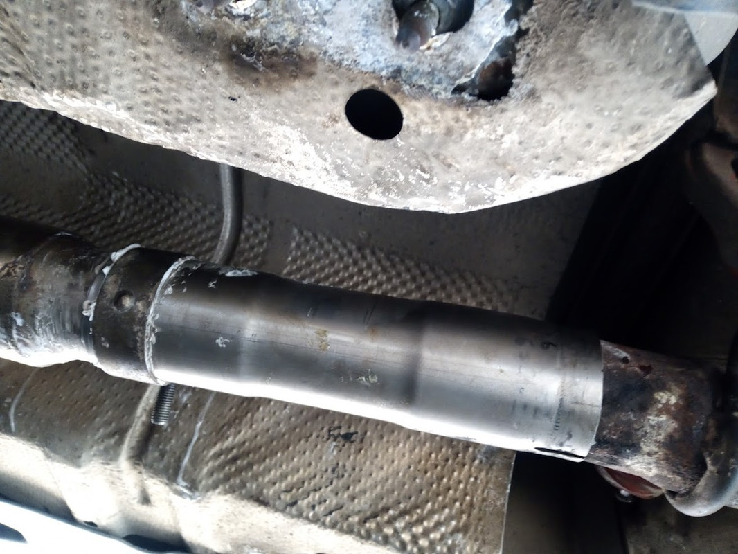

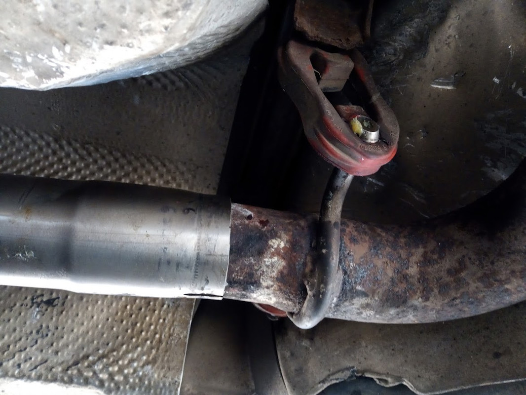

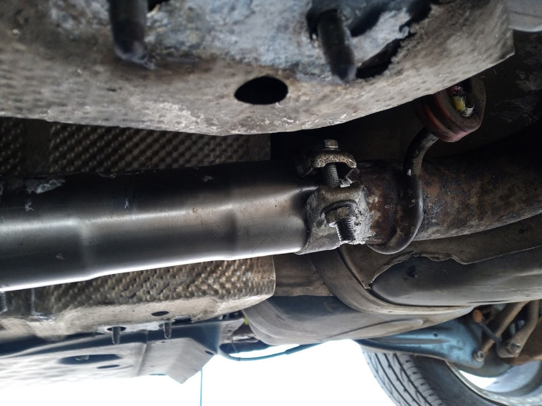

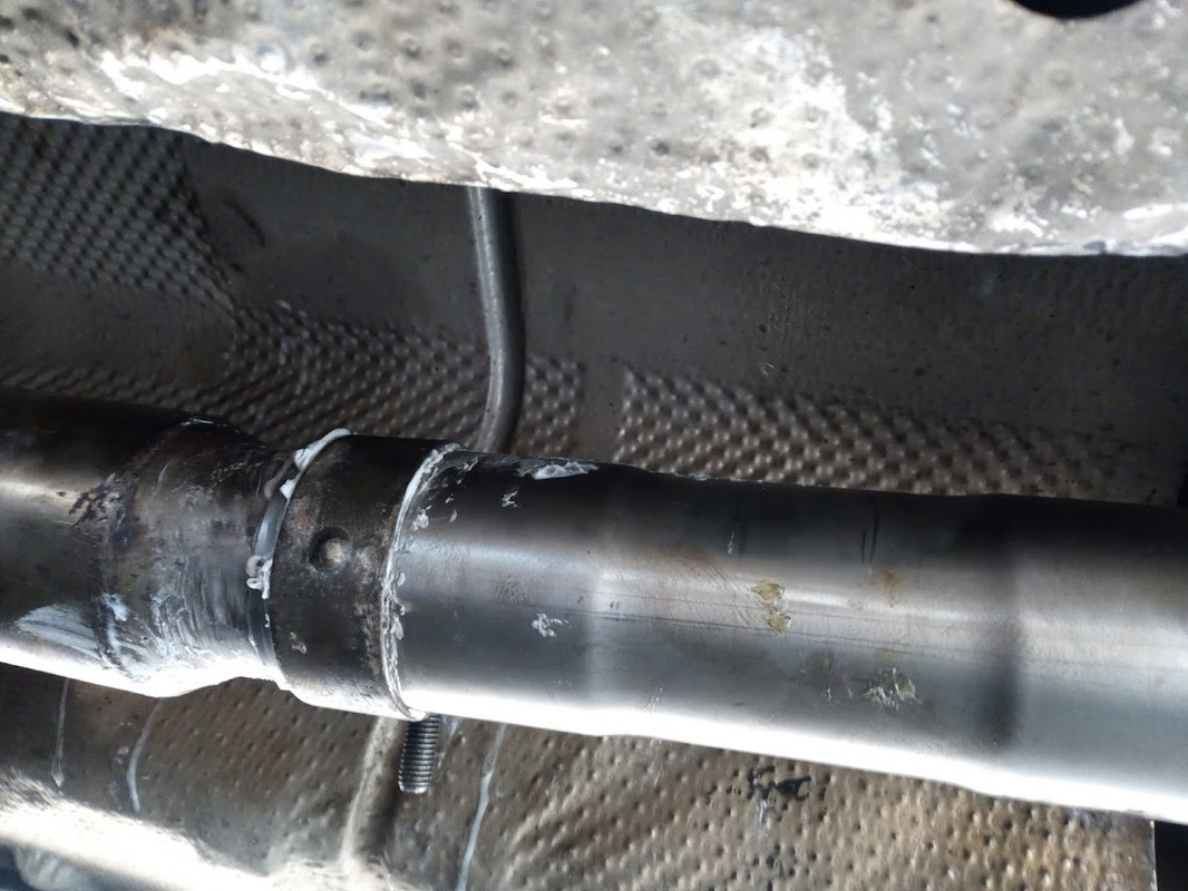

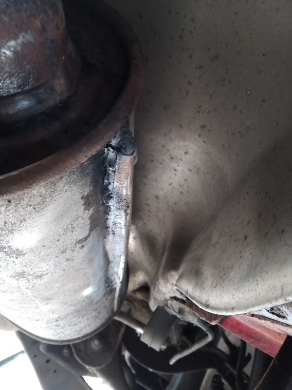

Also replaced the joiner between the rear siencer as the old one was starting to blow even though I tightened it up.  Replaced with  a stainless steel option but used my old clamps from the OE as much better than the ones supplied wtih the pipe.  After replacing I also cleaned up the exhaust pipe and used some matt black heat paint on it to help longevity as I noticed patches of discolouration on the pipe which I know will eventually lead to rust.  Also donated via paypal to the server for the site.
Whilst under the car I also noticed the silencer had started to split which I hadn't noticed before so will need to get this replaced at some point.

Do you have an impact driver? One of the hand held ones you whack with a hammer?

@rich83 No, the only one I have is an electric one Clarke one.
Why do you ask?
« Reply #12367 on: May 22, 2022, 10:26:15 pm »
They are excellent at removing stuck brake disc retaining screws.
Offline ttelracs
  • Posts: 67
« Reply #12368 on: May 23, 2022, 08:17:31 am »
Ahhhh,  yes I know.
I've use a hammer with a screwdriver before to good effect, as well as blowtorches when things get seriousy bad.  This time I fitted a new one as there wasn't one on there and it was annoying me each time I put the wheel back on.
