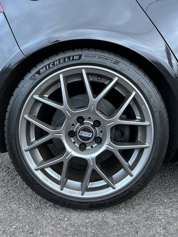

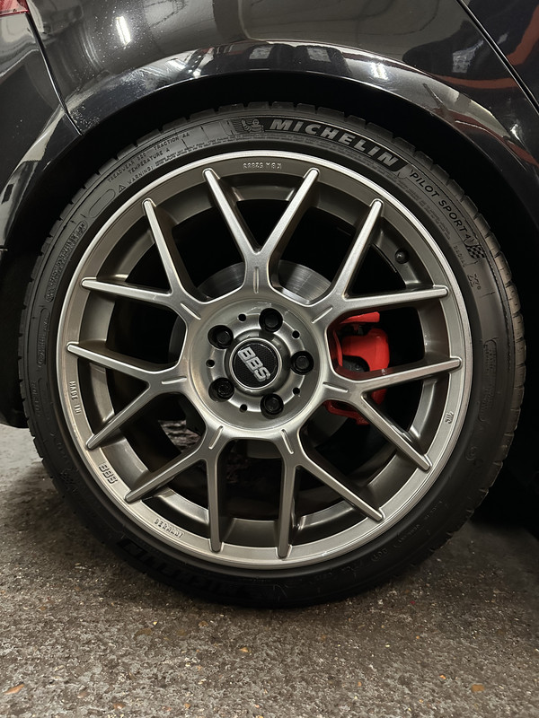

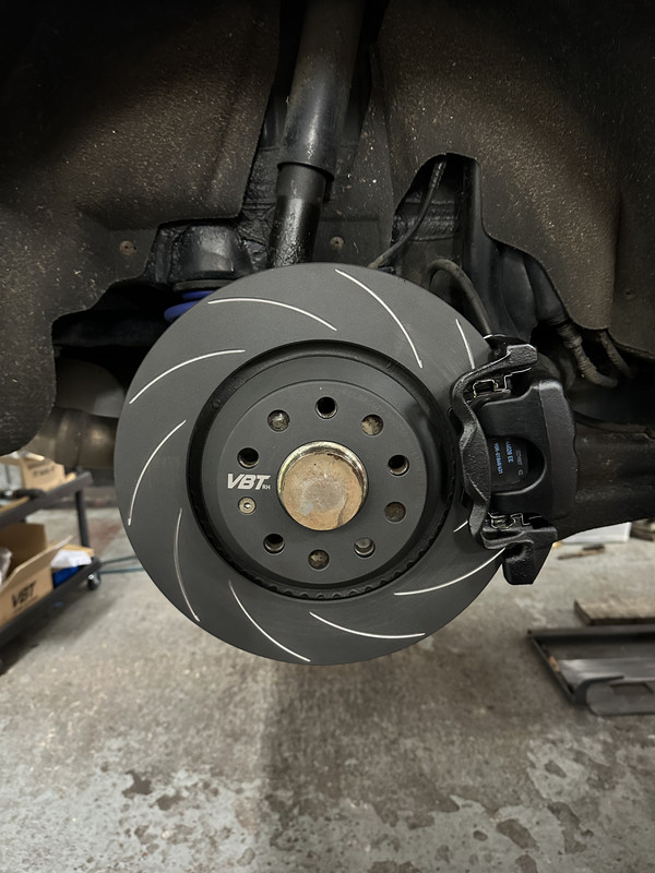

Nearly finished the brake upgrades (just braided rear lines to fit) I’ve gone from standard GTi brakes to the Macan/Q5 fronts with 345mm discs and R32/S3 rears. Still bedding in but feeling good so far. Fronts were done a couple of weeks ago and finished the rears today. Made up new hard pipes from the Calipers to the first flexi hose as the old ones snapped in normal fashion at the ends. Bleeding for a decent pedal is definitely a 2 person job…even with a pressure bleeder!

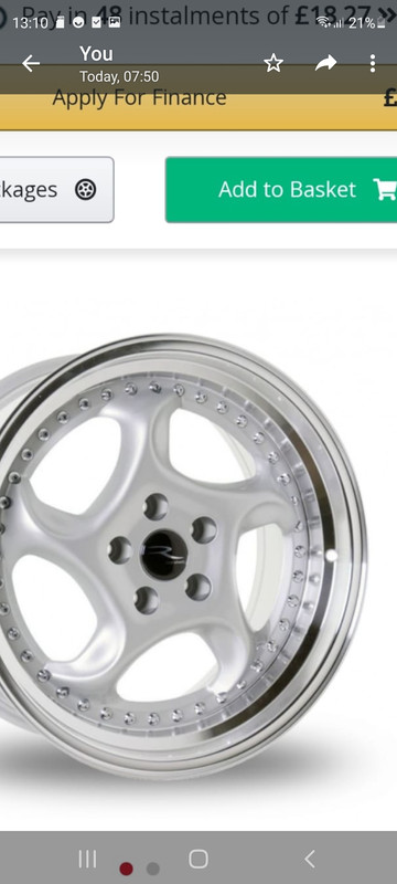

Just ordered new alloys not sure how there going to look and went for 17s
Interested to see how this ends up! What colour car are they going on?

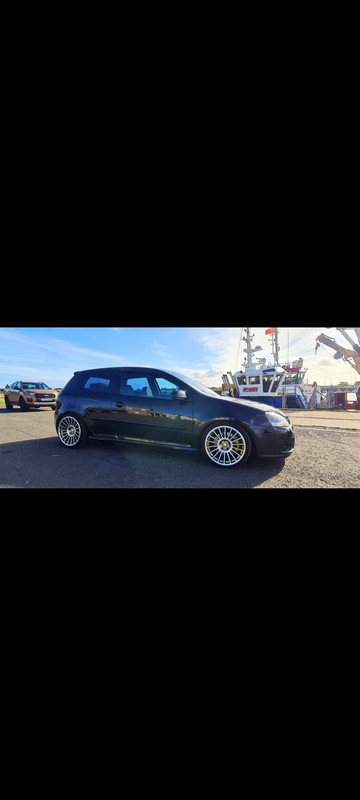

 This one
Very nice. They remind me of the old RH Alurad ZW1 wheels, which looked fantastic on MK5s  :happy2:  I used to have some and I can tell you the polished lips corrode to f'ck very quickly, so you'll be wanting to keep on top of the waxing and minimising winter salt driving.
