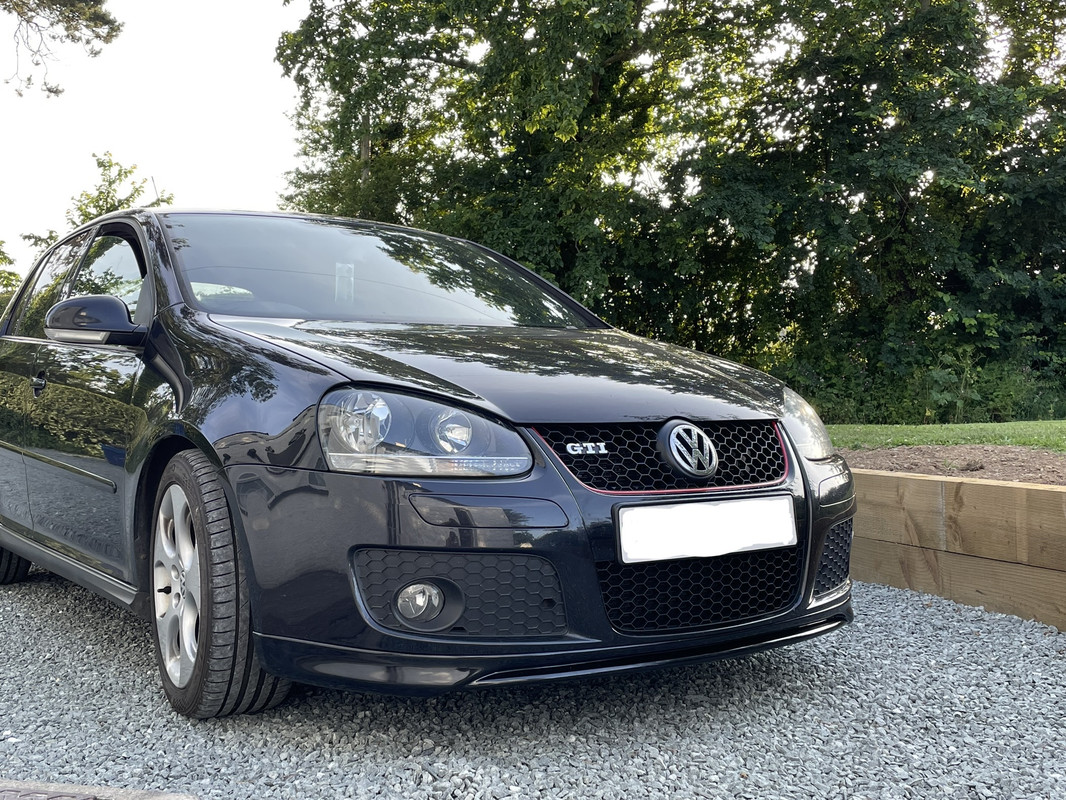

Hit this milestone  :smiley:

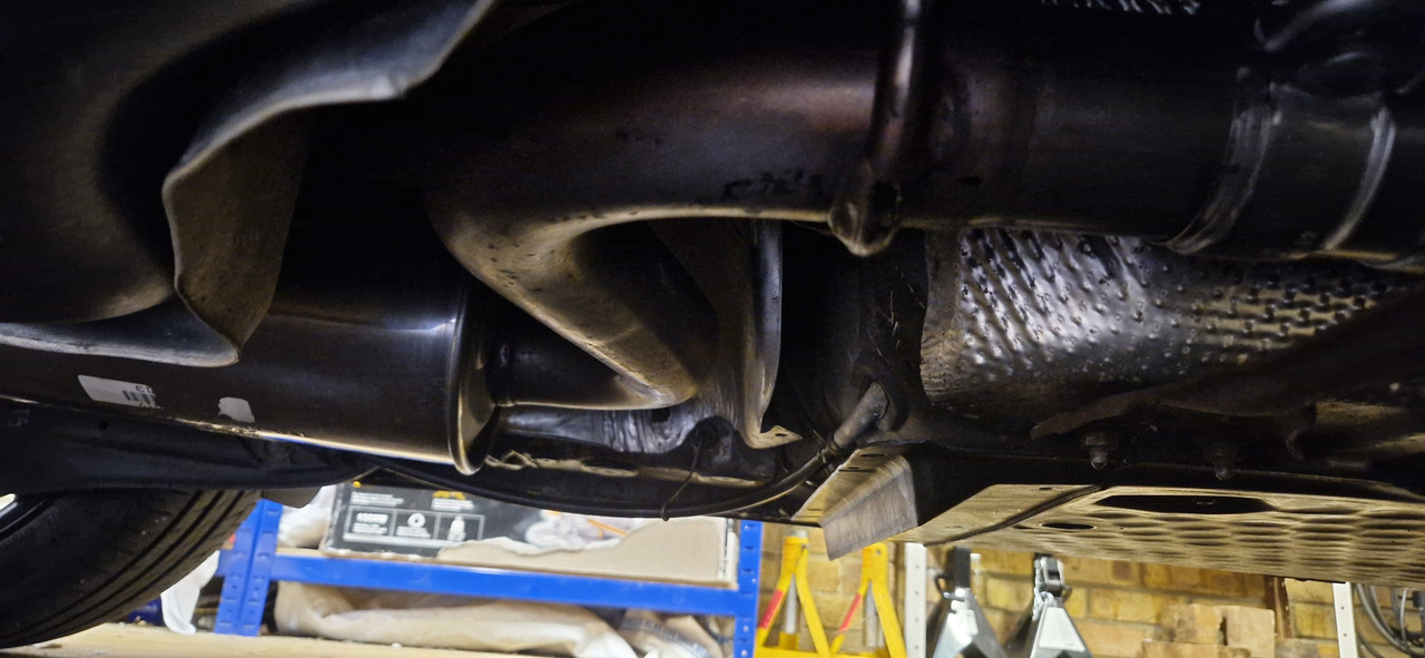

Replaced a bunch of stuff in the last few days.
Had a custom 76mm exhaust made to replace the old smaller piped rust bucket I had on, cleaned the valves, installed VIS HPFP piston kit, new spark plugs and a Stack boost gauge.
Also had new software + DSG software made, I was expecting 340-350 but not too shabby for 180k miles.... Green is old software, blue is new, power on tap for way more of the revband. Love the sound of the new exhaust.

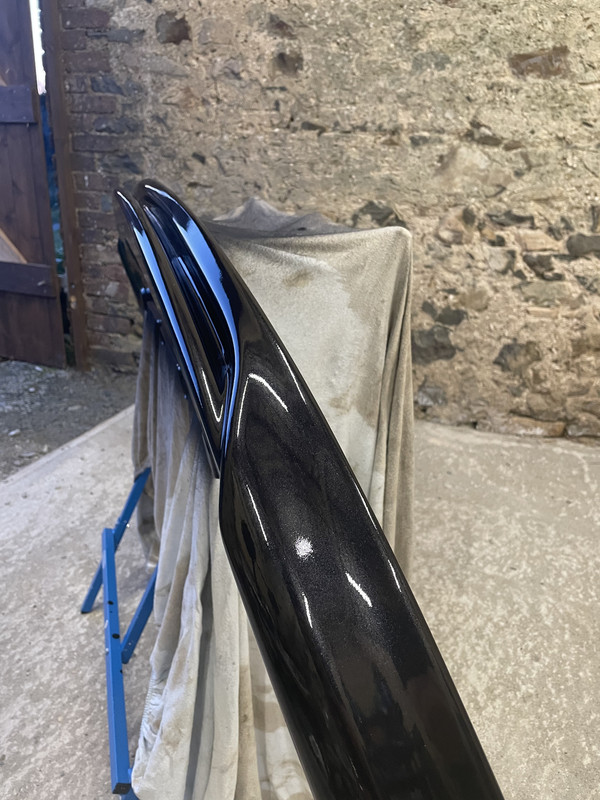

« Reply #12668 on: June 22, 2023, 09:01:15 pm »

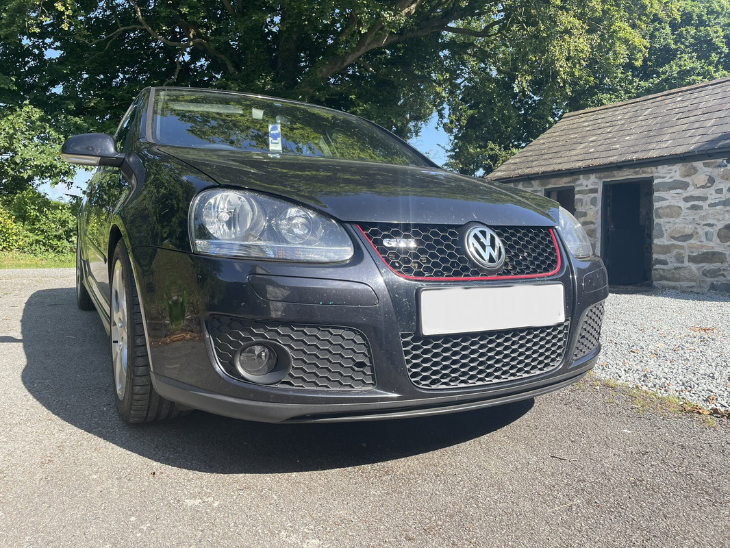

The unusually warm settled weather we've had in the UK has been ideal for some spray painting projects so I went ahead with the task of painting and fitting a (replica) edition 30 splitter. Used 2k clear coat for a hard glossy finish that will hopefully protect it from rocks etc. Definatley needs a polish but I think it looks pretty good. Part was £125 and used around £35 worth of paint. Also fitted a new front lower grill because the old one had faded badly. Front end looking much smarter now. :happy2:

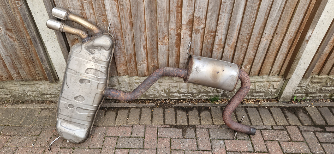

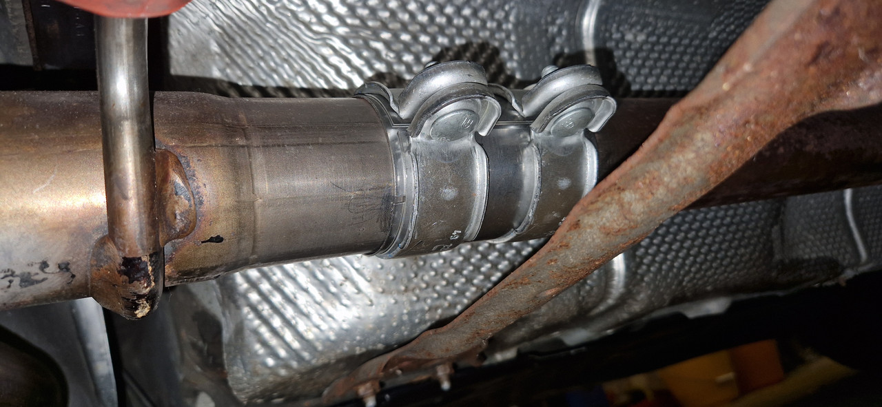

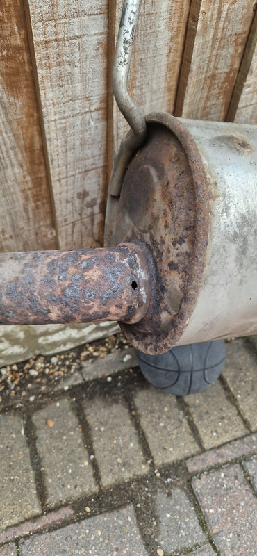

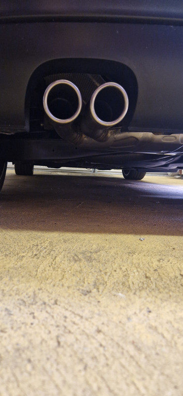

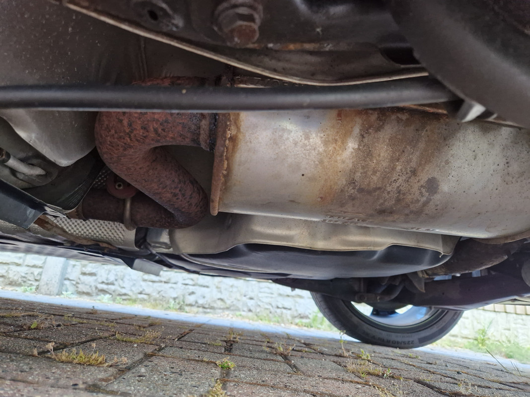

My original exhaust at 15 years old and 100,000 miles was looking quite badly corroded. Having got hold of a genuine VW exhaust off a Jap import car that had only done 10,000 miles I decided to replace it.
Did the job DIY using drive on ramps in my garage. After rounding one of the original clamp nuts I had to hacksaw it and ordered a new one. I found the hardest part of fitting the new exhaust was refitting the front hanger clamp bracket as one of the bolts has to pass through the fuel tank strap.
On inspection of my original exhaust I was just in time with the replacement. The hole is on the topside of the exhaust so would never be picked up during the MOT.

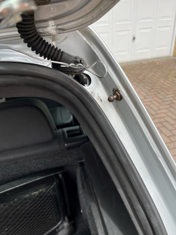

« Reply #12673 on: July 09, 2023, 03:02:32 pm »
Today I fixed the common fault in mk5's where the boot gas strut rips the thread out of the c pillar. using a locking nut and a metal coat hanger and using a bit a threadlocker fluid just to finish the job

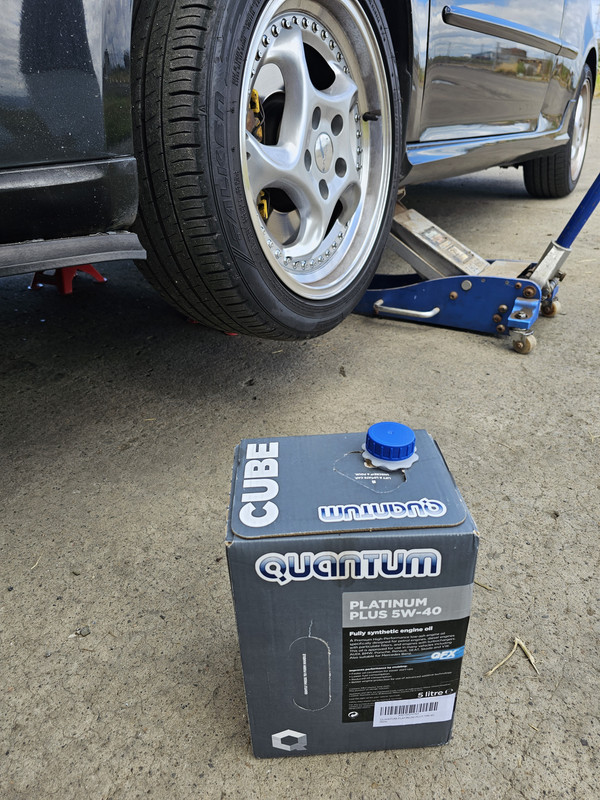

« Reply #12674 on: July 13, 2023, 06:50:25 am »

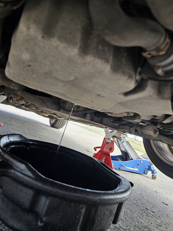

Changed the oil, switched from 10w60 to 5w40. I drive normally and don't track the car so it was pretty useless IMHO.
