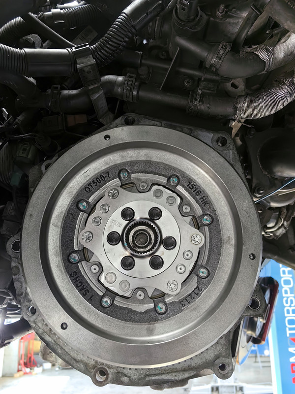

« Reply #12786 on: July 23, 2024, 03:14:01 pm »
Changed the flywheel. Old PN was discontinued, new PN you can only find OEM for 1100 euros... Insane. Fitted a Sachs one, used on diesels with dq250 dsg. Works great and only costs ~300 euros. Sachs part number 2295 000 541.
That pilot bearing is a massive PITA to take out without the proper VAG extractor tool. We chiselled away at it till it came out in little pieces, wasted an hour on that crap and it's a 30sec job with the tool. All the youtube guides with bread / grease are useless.
« Last Edit: July 23, 2024, 06:31:56 pm by skkane »

Offline fakie1977
  • Posts: 229
« Reply #12787 on: July 23, 2024, 08:32:22 pm »
What was the reason for needing to change the flywheel? How many miles had it done or what was the symptoms?
Offline skkane
  • Posts: 115
« Reply #12788 on: July 23, 2024, 10:25:32 pm »
No idea how many kms on it, car had ~270k when I got it 2 years ago with 4 previous owners. It has ~309k now.
It rattled one time in N during standstill and was pretty rough / jerky when coming to a standstill after a while driving thru bad city traffic. The shift from 2nd to 1st was pretty crap, dropping revs to ~600, felt like a beginner driving a manual transmission and almost stalling the engine.
It was definitely livable with as I don't really drive that much during rush hour but changed it for peace of mind. Drove all day and it felt smooth as silk.
2007 ED30
Offline GreigC
  • Posts: 177
« Reply #12789 on: July 24, 2024, 10:29:29 pm »
Interesting! Is this for a MK5 GTI or Diesel?
Offline skkane
  • Posts: 115
« Reply #12790 on: July 25, 2024, 03:03:50 pm »
This flywheel is used on the 2.0 tdi's.
    2.0 TDI, 10.2003 - 11.2008, 1968 ccm, 136 CP
    2.0 TDI, 12.2004 - 11.2008, 1968 ccm, 140 CP
    2.0 TDI, 11.2005 - 11.2008, 1968 ccm, 170 CP
    2.0 TDI 16V, 10.2003 - 11.2008, 1968 ccm, 140 CP
    2.0 TDI 16V 4motion, 08.2004 - 11.2008, 1968 ccm, 140 CP
    2.0 TDI 4motion, 01.2007 - 11.2008, 1968 ccm, 140 CP
I've heard US guys using the regular GTI / 2.0 tfsi 200hp one. That one was more expensive by about 100 euros. It was my tuner that suggested that I get this diesel one, they use it on all their dq250 cars when it's time to change apparently.
