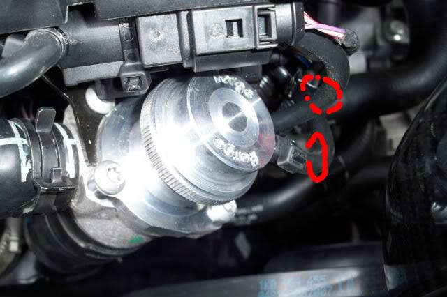

Do you have one of these under your bonnet?

« Reply #5 on: June 16, 2011, 08:51:29 pm »
You've made me scared to look now ;)
Very pronounced hissing.

« Reply #7 on: June 16, 2011, 09:33:24 pm »
Goes to photobucket to dig out pic*
The soft rubber ones the same diameter as the tubes used for window washers.

« Reply #10 on: June 16, 2011, 09:54:38 pm »
The hoses in/out of the sensor in the top right of the pic too  :happy2:
