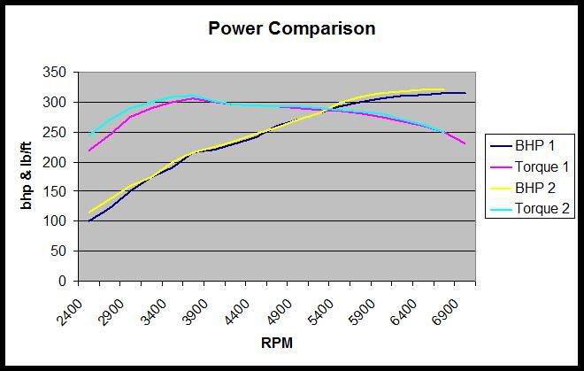

I've consulted JonnyC about most mod's on my car (from when he had his S3) and what he doesn't know about the 2.0TFSI now after all the work his done across three cars, well frankly, isn't worth knowing.
I've spoken to him about exhausts and yeah, of course a full system will give you the best results, but I need may car to appear relatively stock for when i'm visiting clients... plus the boss (AKA my girlfriend) would have a word with me about something like an aftermarket exhaust.
Anyway, with the new facelifted S3, lot's of people have had issues with misfires after having remaps done... nothing new, as a lot of people suffered injector issue related misfires, but on the facelifts the injectors were not the cause.  The downpipe is slightly different on the facelift S3's and this was the cause.  Basically, it is the most restrictive part of the whole OEM system on all 2.0TFSI cars (when you see it next to the Milltek you can really see the difference), and the OEM backbox is pretty free breathing anyway.
So, I put just the Milltek downpipe on as a bit of a test to see if for 40% of the cost, you can get 70% of the performance gain and you guessed it, Jonny was bang on the money I've seen an increase in headline figures of 7bhp and 6lb/ft, but that is only part of the story.
Here is a comparison from when my car was just a map and panel filter and then adding the down pipe:
You can see low end torque is much improved, and power is pretty much improved all through the rev range.
You can definately feel the difference, plus the exhaust note is improved.  :happy2:
I'd recommend this as a cheaper alternative to a full system and it will deffo yield more performance gain than just the back box.

top write up Jamie, this was a route I was thinking of taking as well but then E-bay through up a cat-back I couldn't resist :smiley:
without being picky though, it wasn't the facelifted cars that started with the downpipe issue on the S3's, it was the 08 pre-facelift where something changed and the issues started as far as I know, I had the issues and they all dissapeared wehn I put the downpipe on :happy2:

Thanks Jamie power graphs before and after :happy2:. some folks said that the stock downpipe was ok and not as restrictive as the prev mk4 version so thats something for me to think about once the modding moderator lifts my ban.

nice data Jamie thanks  :happy2: never even considered the downpipe only ......

 :signLOL: no test is complete with some stats to support it!
@ Gaz - not picky, and yeah you're comepltely right, I remember someone mentioning that 08 cars had the same issue (may even have been you  :P )
@ Keith - when you see the two side by side the OEM downpipe is very restrictive - narrowest part of the whole OEM system
