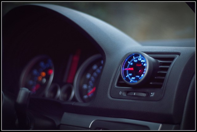

A boost gauge is the only real way to to know  :happy2:
2/52 by Damoegan, on Flickr
