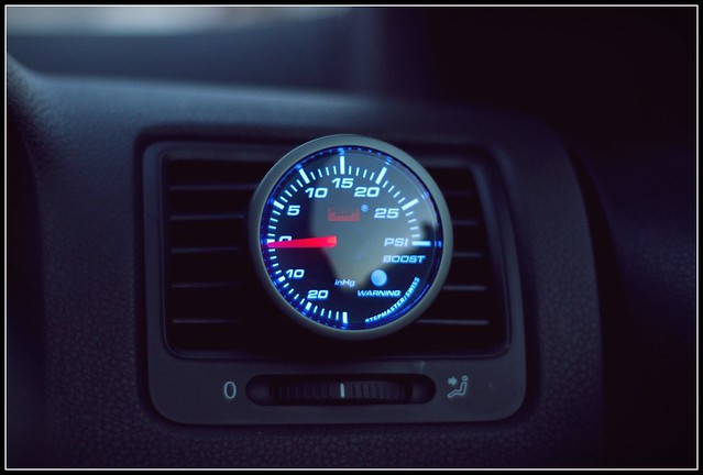

Morning chaps,
I've just bought a boost gauge similar to that of Robin's but it fits in a pod in the air vent.
Are these easy to plumb in myself or is it worth paying a garage to do it? (+how long would it take them)
Thanks in advance, :drinking:
Nick

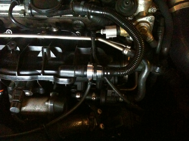

« Reply #9 on: July 25, 2011, 06:13:55 pm »

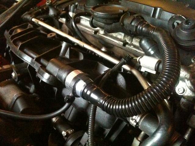

Dum dum dummmmmm......
Installed the boost gauge by running the boost pipe into the breather pipe using a fancy little metal t-piece thing that attatches directly to the breather pipe.
The gauge works perfectly, but there is an annoying buzzing/rattling noise when boosting.  :fighting:
I've read about an anti buzz t-piece, and I think I have it in my kit, but I have no where to put it in my system, as the pictures will show, as the boost pipe runs from the metal t-piece directly to the gauge and no pipes have been cut...
Any ideas wise ones? :notworthy:
Offline damoegan
  • Posts: 1584
Re: Boost gauge fitment
« Reply #10 on: July 25, 2011, 06:34:00 pm »
All you need is something in the vac line to reduce the internal size of it...
Or you can get this... http://www.awesome-gti.co.uk/product.php?xProd=6780&xSec=153
