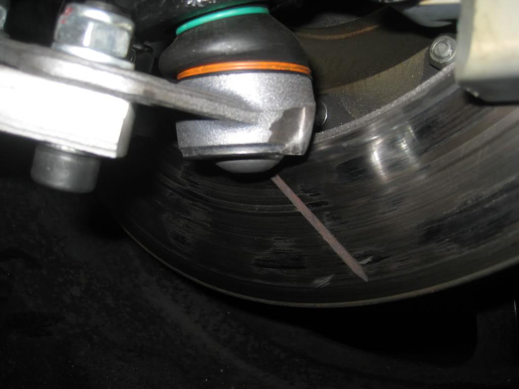

Ok so there is no reason yours should be any different from ours however, don't just keep grinding away untill they fit!!!! It is only the bottom outer radius that we reduced by about 2mm. Very difficult to explain, let me take a picture when I get to work, it will explain all. Was in two minds whether to mention this because it sounds like a proper lash up. Ours were genuine tt joints, and there was more than enough meat to play with. Picture to follow.....

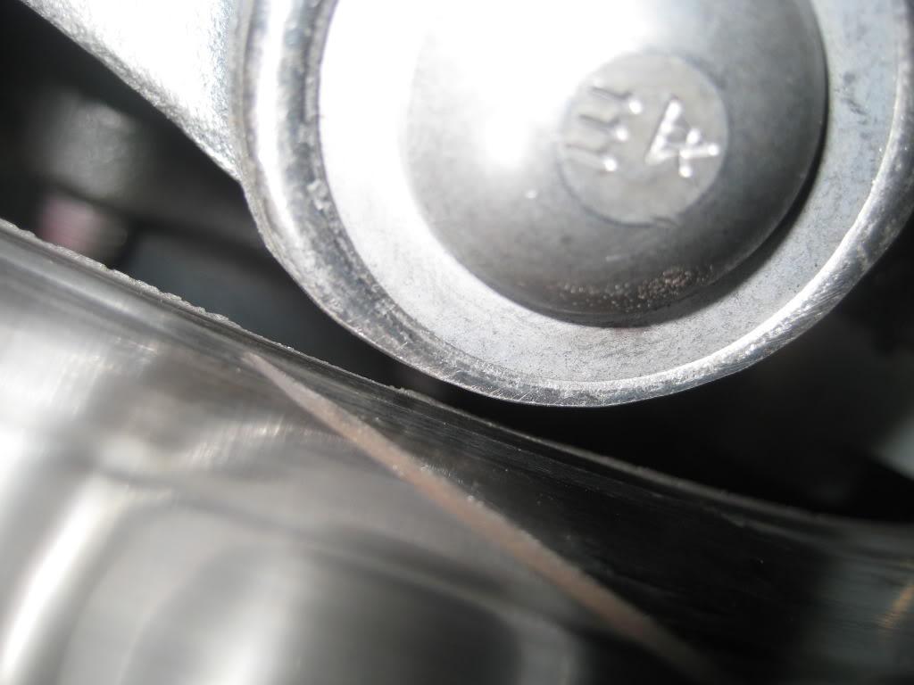

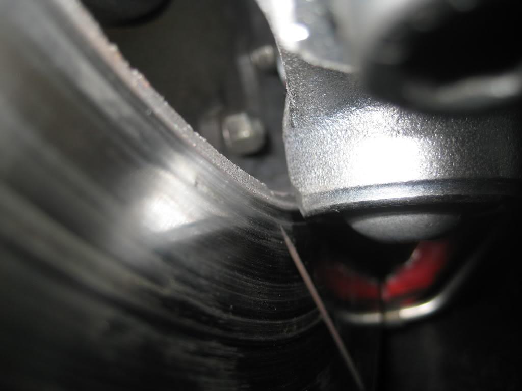

right some piccies
the above shot from underneath, gives the best indication of how much we removed, very important you dont break the pressed in sealing plate at the bottom side.
the shot above from the front where we had to relieve it further round than the following shot from the rear.
we really didnt have to take much off at all but other cases may differ, since these were fitted we even tried fitting various different pattern joints but as yet have not found one any smaller in body than the genuine ones. if i can be of any further help let me know. :happy2:

Also be aware that the tt ball joints usually fit under the wishbone rather than on top. This may push them further towards the disc.
This doesn't affect how the ball joint clears the disc.  :wink:
