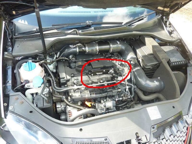

Thanks chap, where can I find the valve and what does it look like?

Follow the ribbed hose that attaches to the right side of the intake manifold (looking at the engine); at the other end is the plastic pcv...

mine has the pcv revamp kit on it.
