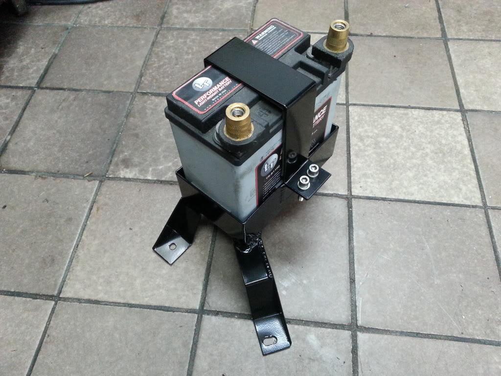

I am running the TR Performance battery? Recommend it. Will post up my battery tray if my photobucket works for me.

Design copied from the website....ssshhhhhhhh.

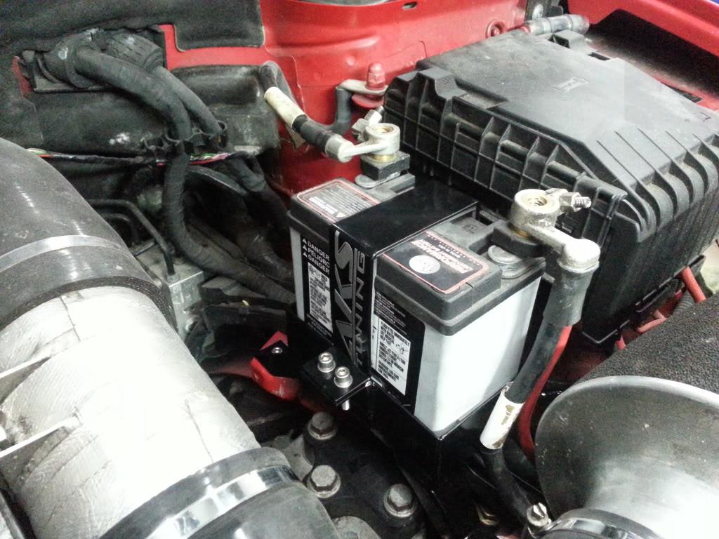

That mounted in oem position or boot?

Engine bay mounted Mike.
