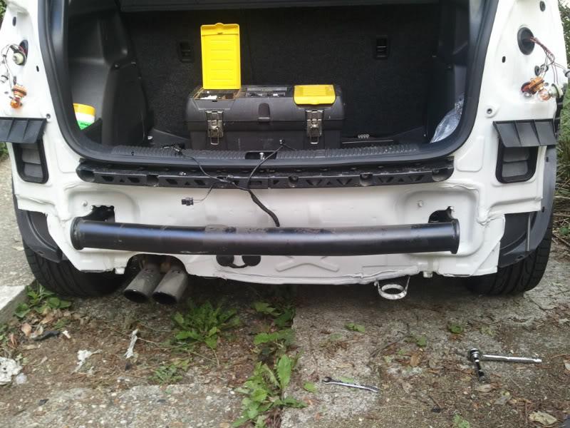

Well i removed the rear bumper and the ballast weights from the car today.  Almost gave up as one torx screws was defeating me for about 45 minutes because i couldnt get to it well enough to crack it then unscrew.
So i removed the wheel and arch lining in the end.  Job done.
I cant believe they literally just bolted 25kg of metal weight to the rear crash beam.  Easy and cheap method of weight loss though
Just driven it, and it is notably improved with the back end being alot more lively.  Much less understeer, definitely a bigger difference than i expected to be honest.  Probably to do with the fact that they were right out behind the rear wheels that makes it so much more noticable
Pic below is not my car, but the weights were fitted to the left hand side of the tubular crash beam

I still can't believe that they simply bolt 25kg of ballast to the back of the car....madness!!
