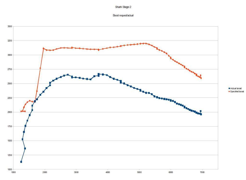

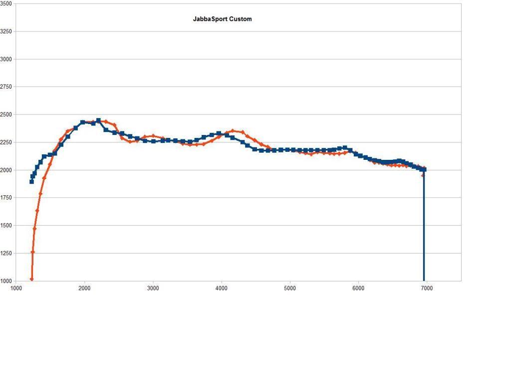

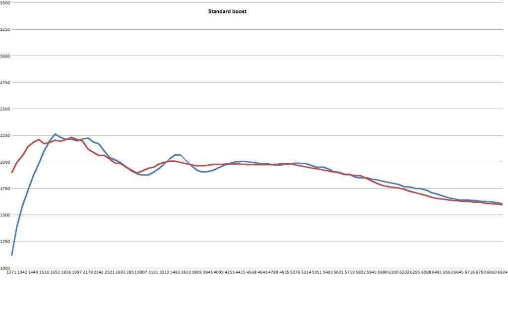

Have my boost values for the stock, shark and jabba maps. All hardware is consistent throughout all logs.  Ive kept the bost scales and RPM the same to make it easierr to compare the boost curves
Will compare these to my hybrid map as well once sorted.
Std  Blue = Actual Boost. Red = Specified(requested) Boost
Peak at 1.21Bar(17.5psi) @ 1600rpm. 1Bar(14psi) from  2700-5300rpm dropping to 0.62Bar(9PSI) at the redline.
Shark Stage 2  Blue = Actual boost.  Orange = Specified(requested) boost
Peak at 1.65Bar(24psi)@ 2700rpm to 1.5Bar @4520rpm before dropping to 0.96Bar(14psi) at the redline.
Jabba Custom Blue = Actual boost. Orange = Specified(requested) boost
Peak at 1.4Bar(20psi)@2310rpm. Dropping gradually to 1 Bar at the redline.

I see what you meant about the requested boost being too high on the Shark map :scared:
Never going to meet that even with a hybrid :laugh:
Hence my N75 waste gate duty cycle being 100% for the ENTIRE rev range
