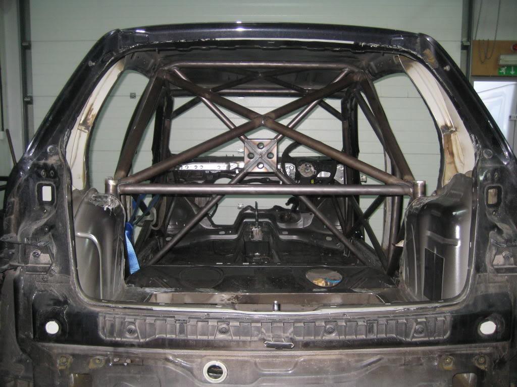

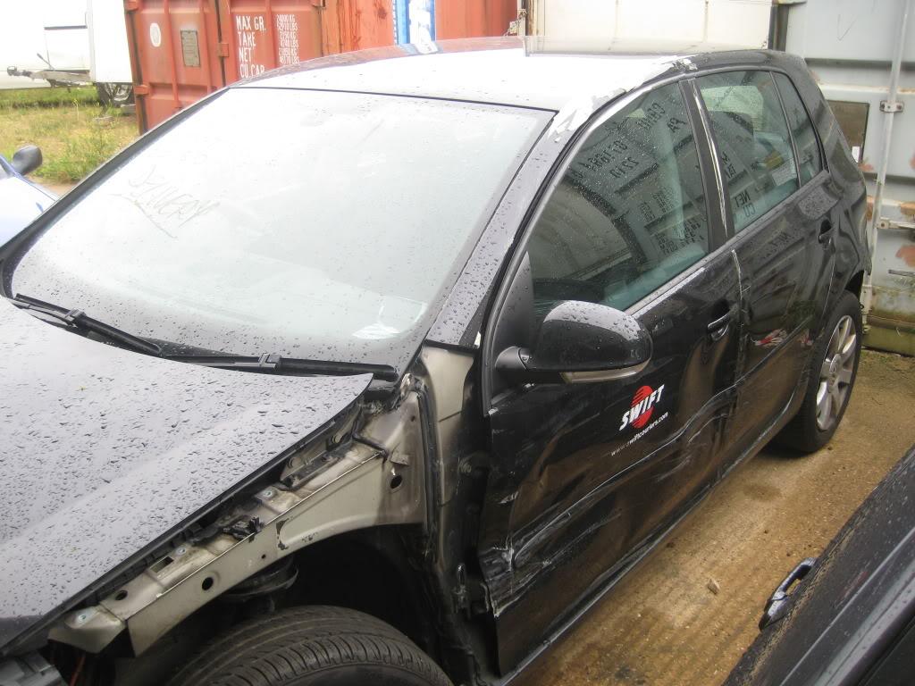

so, its time for some of you to see our latest achievement, it started life as a 140bhp 2 litre TDI BKD courier car (smashed)
in true KPM fashion it was stripped and rebuilt from the ground up.......

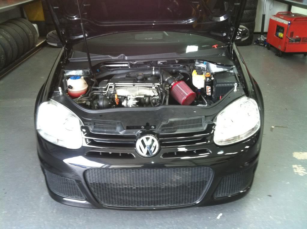

and what we are left with is a 280 BHP race ready 2 litre TDI.
it has 500nm of torque, which in simple terms means it can drive up a flagpole (towing another Mk5)
it did one run on the rolling road at 309BHP, although i felt this might be demanding a little to much from the little courier. so we settled at 280.

standard on something. we take the turbo off a v6 diesel and graft it on the back.

primarily if you smack the side of these racecars, which they do regularly, its much more cost effective and less time consuming to change a door skin, and even door than it is to put a rear quarter on one. we measured about 40kilos difference between a four door shell and a two door shell but then we run to a weight which we nearly always have to bolt weight in to make the cars legal. there is no relevant difference between the stiffness of a 4 and a 2 door car.

Having heard this thing run (It revs like no diesel I have experienced) and seen the video of it on the dyno it's one of the first diesels I would want to own  :drool: :drool:
