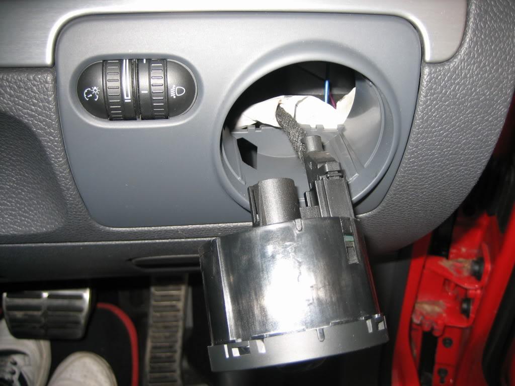

Hey chaps,
Again nothing major just another subtle touch to, this time, lift the interior. I recently purchased a chrome headlight switch from Demon666, cheers bud  :happy2:, so I thought I'd share the removal & installation should anyone be considering the same up lift.
Original headlight switch;
Removal procedure;
Position the switch in the 'O' position, depress the switch, it will push back approx 5mm or so, then rotate the switch clockwise the 12 o'clock position. It should look like this...
Carefully extract the light switch, remember there's an electrical connector situated at the back, the light switch should come far enough out to allow easy access to connector itself.
Simply disconnect the electrical connector and connect to the new headlight switch and carefully insert the switch back in to the recess insuring it clicks in to place and wallah, brand new shiny headlight switch.
