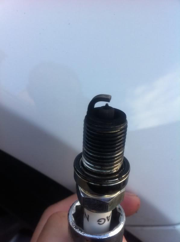

there isnt any smoke at all on idle, them when you drive, occasionally theres a large cloud :confused:
Plugs dont look very healthy IMO, but I'm no expert!
Could it be anything to do with the high boost at 3000rpm?

Yikes looks like most of it flying out the back of the exhaust then! :confused:
