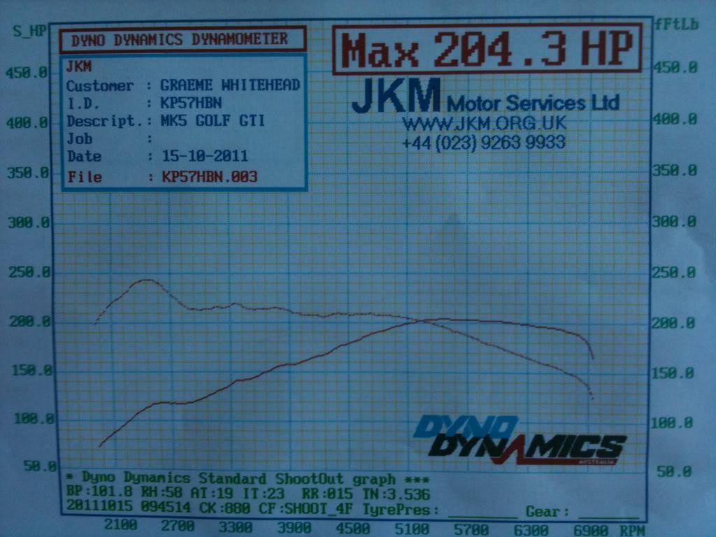

Fantastic day - and great to put faces to names  :happy2:
Here's my graph:
Very pleased considering its only mod is a K&N Panel filter  :pomppomp:
