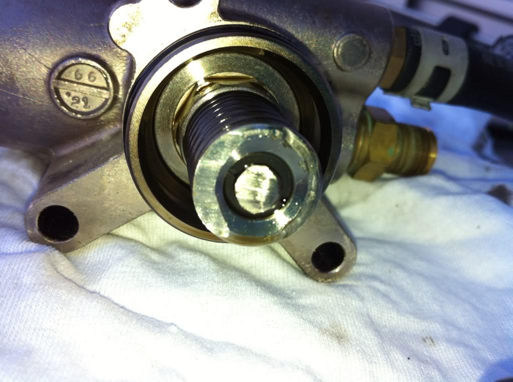

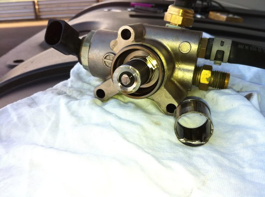

New split topic, following NeilM's issues yesterday I have split this topic off  :happy2:
Pic's as mentioned  :scared: :scared: :scared: :scared:
Bloody hell!  Will be driving like a gay when I get to a track day now  :scared: :scared:

Neil's car had done 59k and about 15k on the Autotech internals.
We also checked mine and found the coating gone and some pitting on the surface, so a new one is due in tomorrow morning.
I don't believe this is an uprated one available.
