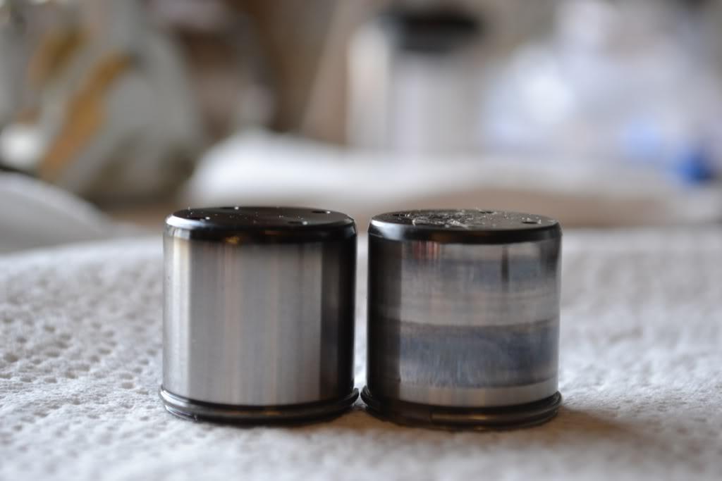

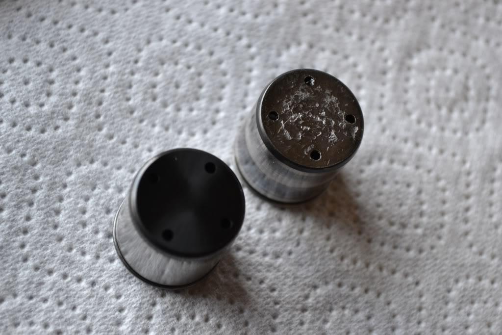

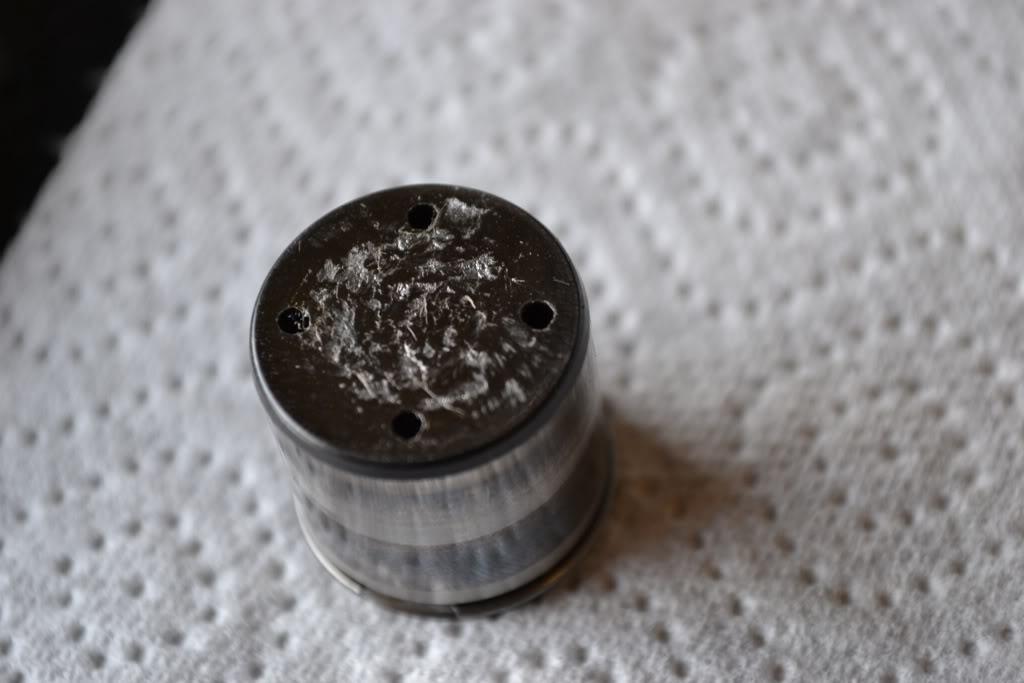

Swapped my follower today, here's what I found
Old follower
Vs. New

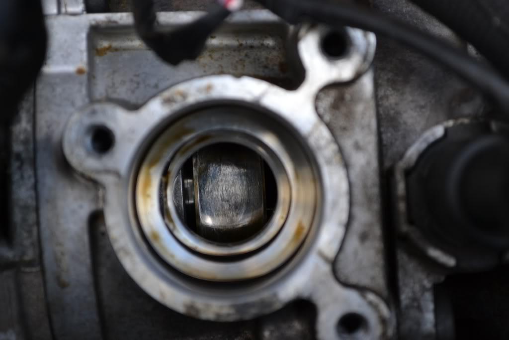

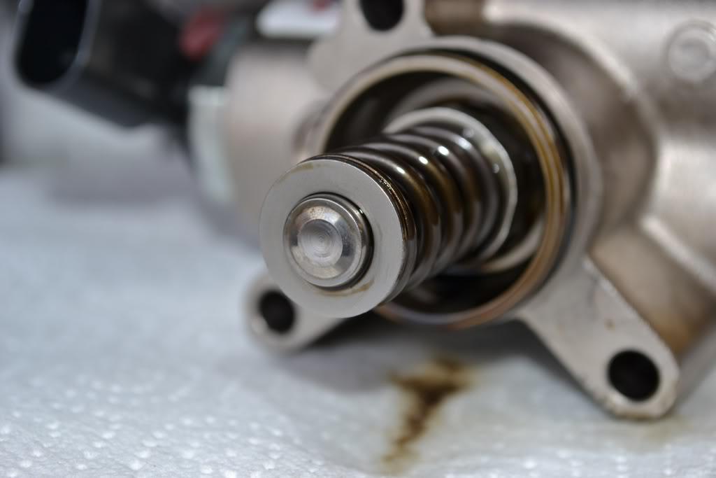

APR pump showing no major wear at all
And nothing major again on the cam either

Why is the old follower full of pits?  Have you checked all of the camshaft lob for damage Steve?
 :surprised:
Re: HPFP Cam Follower Issues
« Reply #32 on: September 11, 2011, 05:11:28 pm »
Cam lobe was pictured above, wear looks even and negligable...
Saint Steve
« Reply #33 on: September 11, 2011, 05:12:10 pm »
Only half of it mike....
What's not to say the other side has a nasty Pit causing that damage ..
