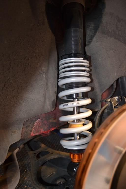

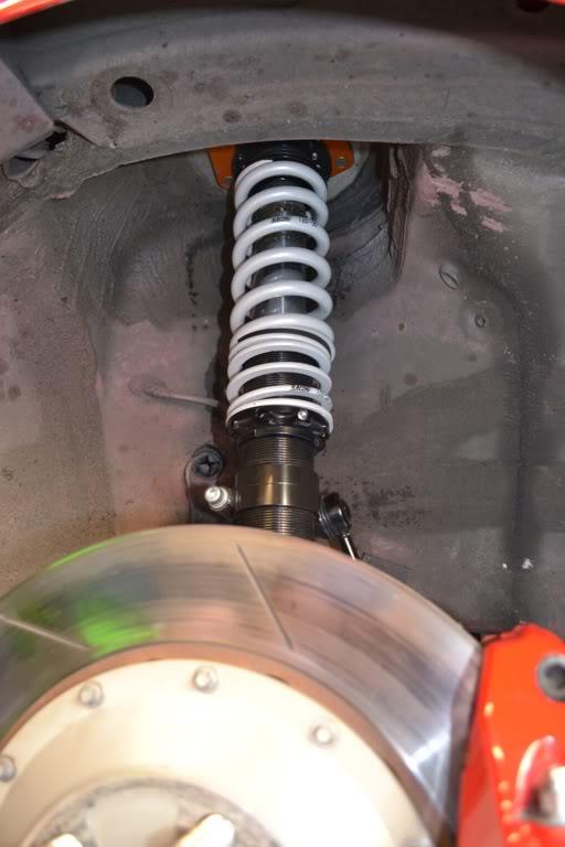

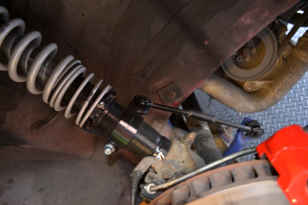

Here are some pic's of them installed on my car: -
Fronts: -
Comes with their own drop links

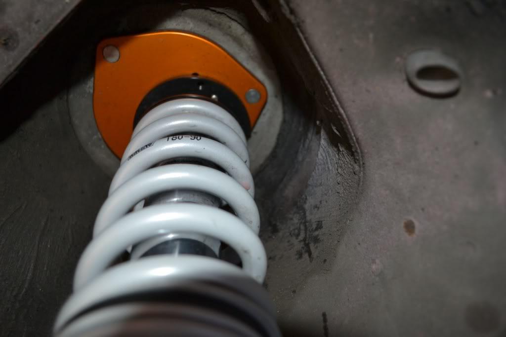

Mounted into AST's own adjustable top mounts

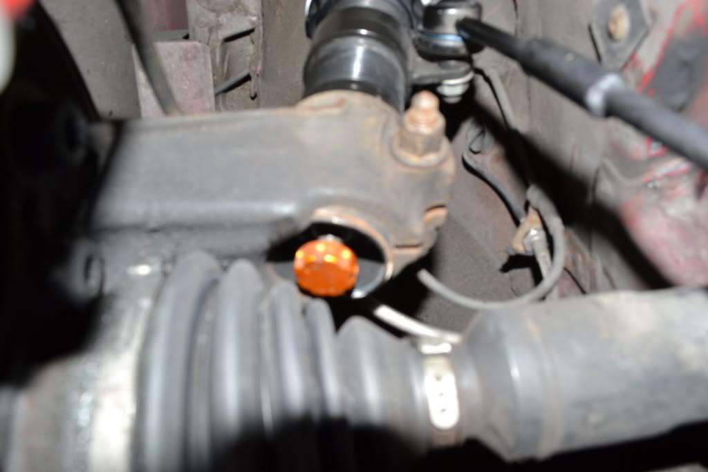

Easy to access the adjustment knob on the base on the strut

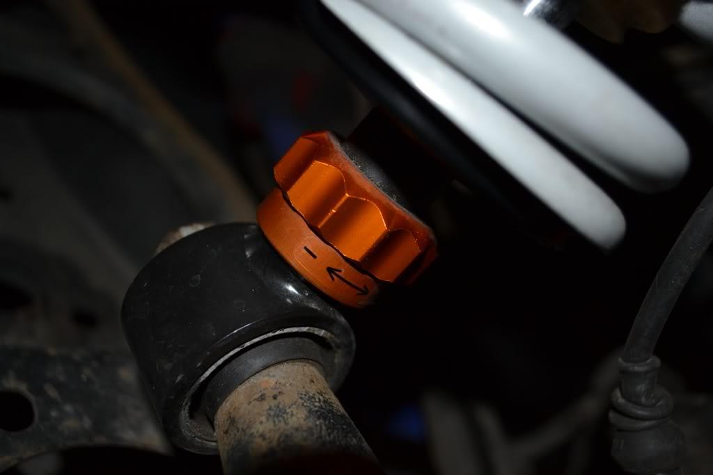

And the Rears: -
Rather than the normal damper and separate springs, the AST's use a rear coilover
And again easy access to the adjustment knob on the base of the damper

I wonder what the benefits of the rear coilover are? Certainly looks like quality kit!
IMO the further from the center the better the spring can be made to adjust, as it get's a longer travel to work with. That's a plus in my book.
A minus from looking at the photos is the height adjustment on the front. There's nothing from stopping the tool slide out of the notches in the ring that you adjust it with. Same flaw i find in the KW design. Though this looks a bit better as it's not fiberreinforced plastic mut alloy from the loks of it.
How do you adjust front camber and rebound ?(the top adjustment)?
How do you adjust rebound? (the top adjustment) on the rear?
The spring setup front consisting of 2 springs, is the progressive or linear springs?
Are they utilizing up side down technology?
Camber is adjusted on the top of the top mounts: -
Rebound isn't controlled separately to the damping on the 2 way kit.

By the looks of it the height adjustment ring has holes for the adjustment tool. Very secure way to move the lock ring.
The top mounts require the hole on the car to be chopped out too so bear that in line for the DIY fitting.

After looking at the Photos i can see the are Upside down, same as Bilstein, meaning a bit less unsprung weight. another plus for me  :happy2:

In respect to the high spring rates (90 and 110 N/mm) corner weighting is a must, Steve !!
The main springs are linear.
The helper springs are softer than the main springs. I bet they are ''closed'' when the car sits on ground.
So they keep tension when car is lifted or a wheel looses ground contact. This also improves traction
on corner exit slightly.
Furthermore I wonder why AST uses such high spring rate on rear. Depending the coilover construction
used on rear as well the rear spring virtually acts much stiffer than on stock position.
Factory (and most aftermarket) springs (for factory position) are equal to or softer than front spring.
So in the case of AST both aspekts tend to stiffen the rear: outwards positioning and the stiffer spring
itself. This should turn the handling away from understeer to a remarkble amount of oversteer imo.
