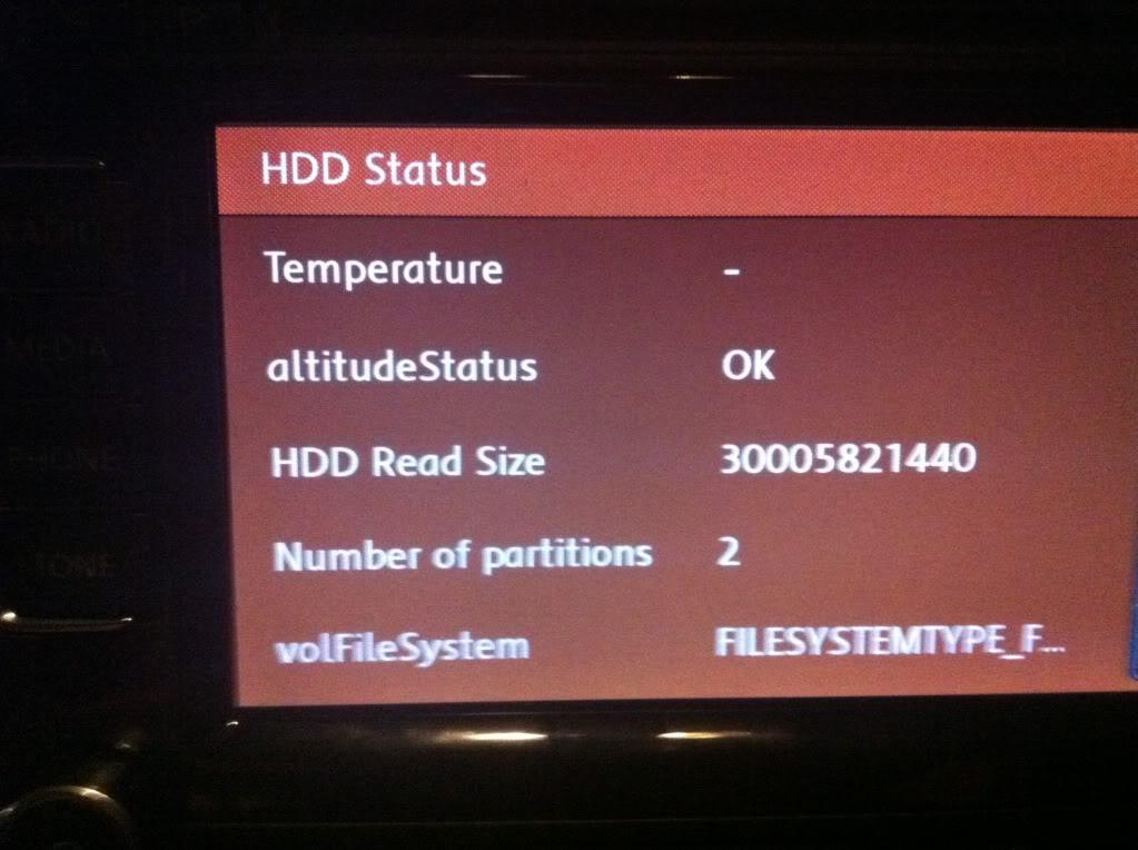

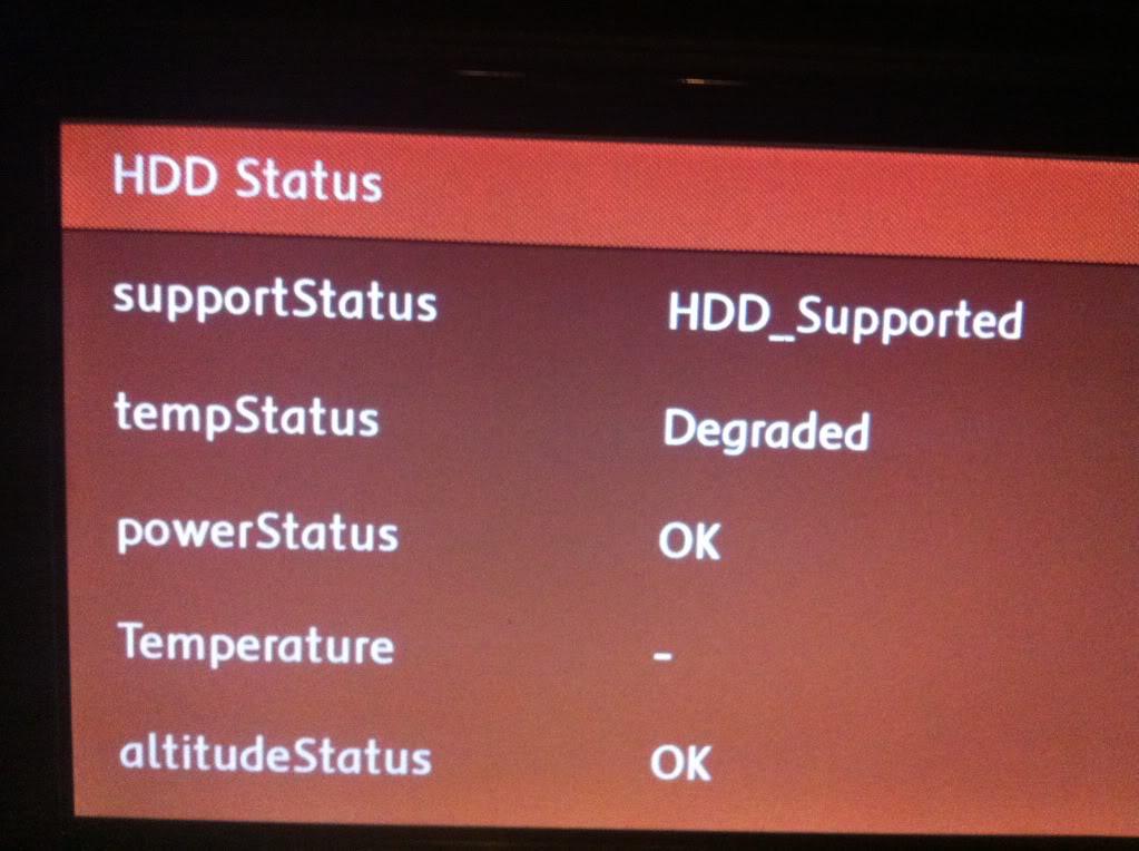

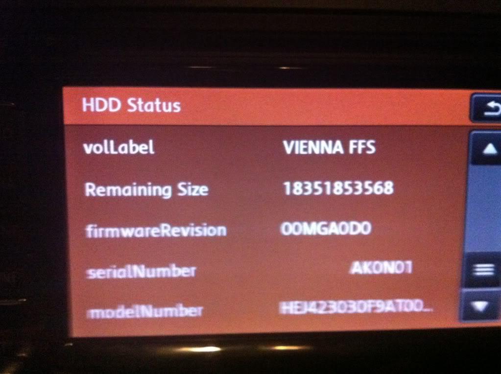

When you go into the test menu what does it say in the HDD status report?
I am surprised that the HDD Format disc didn't delete everything. The Drive is obviously not locked as you can copy maps to it. I'm just wondering if somehow your MP3 Partition has been locked but i can't see how.
Not saying your being a numpty or anything but you are trying to delete off the HDD and not off an SD Card? :laugh:
Status report:
No, I can confirm that I am NOT trying to delete off the sd card!
