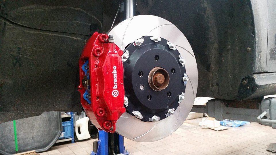

We've got a 343mm floating kit that should fit under a 17, I'm just waiting for the guy who's running it to come up with a review/discussion thread as he's undertaken to do.
343 is very optimal for a Mk5 its on the cusp of needing to be floating so we'll be offering it bolted and floating .
The customer was in a stage 2 Pirelli and completed over 100 laps in 10x10 sessions and evidently was scaring the bejezus out of all sorts of exotica, Alex AKS fitted it (as he does with most first time kits)
Its got reasonable consumable prices too, by all accounts it worked exactly as intended zero fade over 2-300 track miles, non pro driver, available to be driven to work the following day. Im hoping that it will become the baseline Mk5/6 track kit for serious track day enthusiasts who want to run a 17" track wheel but fancy some brakes that will hold its own behind a 18/19 street wheel
The track day above was done on the floating setup and Pagid RS4-2.. Pricing isn't finalised but as fitted it was less than £2k
Some may recognise the poor camera skills and messy workshop floor
Edit: The rotor is a homologated item from the Astra VXN race series thats exclusively at the ring so its got some pedigree
