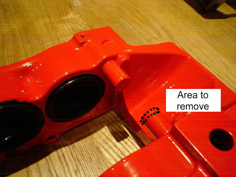

The only other thing that needs to be done to the calipers is for a couple of mm max of the pad-retaining pegs in the calipers to be filed / Dremelled / ground down to accommodate the 25mm thickness OEM disc rather than the 24mm Porch disc. This should be easy with the soft alloy metal ( pic above and below courtesy of DaveB1970):

Regarding the "area to remove" part. Is it necessary to remove 1-2mm from all 4 retaining pegs? Or just from that one that is marked in the picture?

You need to remove from all pegs you should read the main write up for the nqs bbk for the full details.

its near the start in the first few pages, which will help as its now such a massive thread, its a couple of mil from each pad peg to help with the clearance as boxster discs are 24mm wide and GTI are 25mm wide.

Correct, just a couple of mm is plenty. The soft alloy means that it is quite easy to file down.
