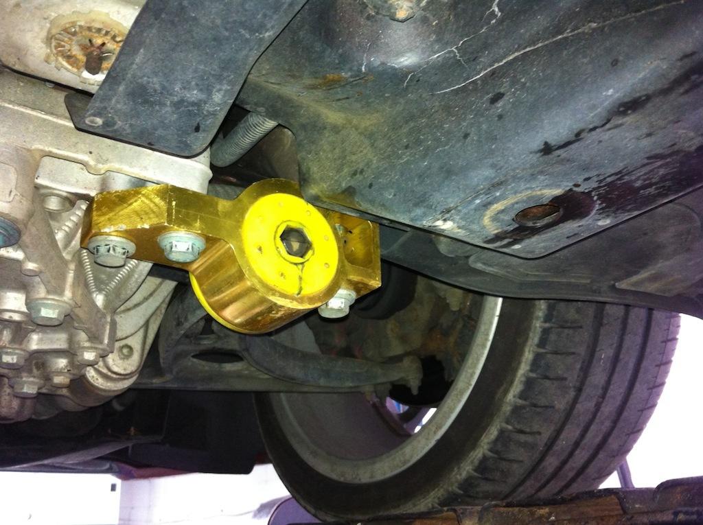

The mod's you've fitted are exactly what I'd love to do to my car.  Im just worried about the ride quality as its a daily driver.  Has it been affected massively by the improvements you've made.   I don't want to alter the character of the car just improve road holding of the car and reduce the "lean" as you attack a corner
Why didn't you fit a front ARB if I may ask?  I really like the look of your car it looks very nice.
Dont know if your near cambs but your welcome to test it.
Its very slightly stiffer over bumps that standard. but today driving it to be honest it feels like ive already got used to it and didnt notice the extra stiffness.
I think the biggest difference is actually the WALK and the added traction and sure footedness. Its amazing. Car feels far more stable on hard acceleration both straight and around bends.

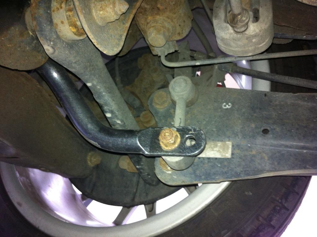

I didnt do the front ARB because i still wanted a little bit of front roll. From what I read and got from others... front ARB was really only of benefit for track days etc. The WALK up front has improved traction and front end hold round a bend.. no more feeling likes its about to let go and shoot you wide now.
The rear ARB is quite a subtle improvement but an improvement non the less and there is definitely less roll.

WALK in place
Rear 24mm Solid ARB on its hardest setting

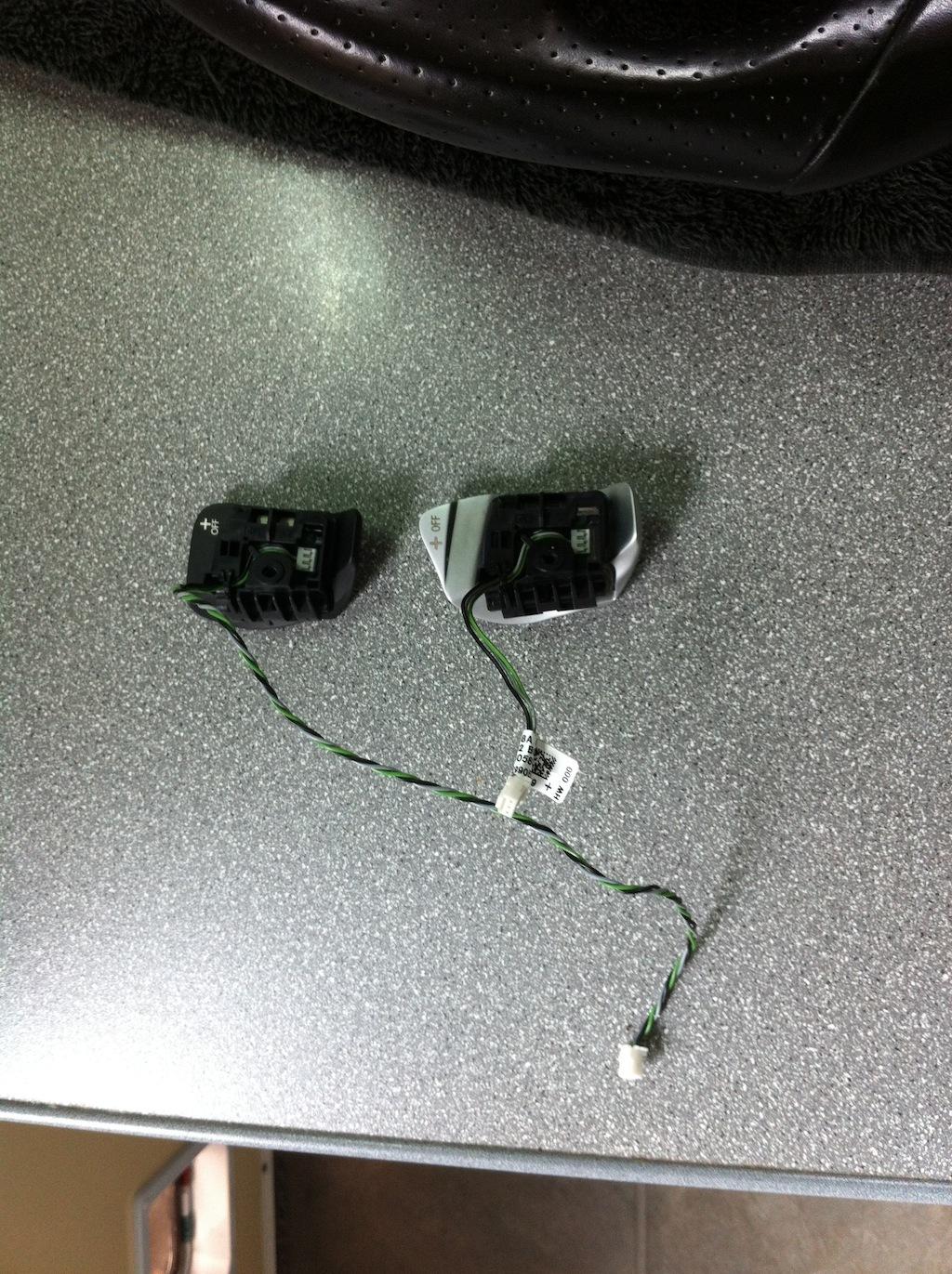

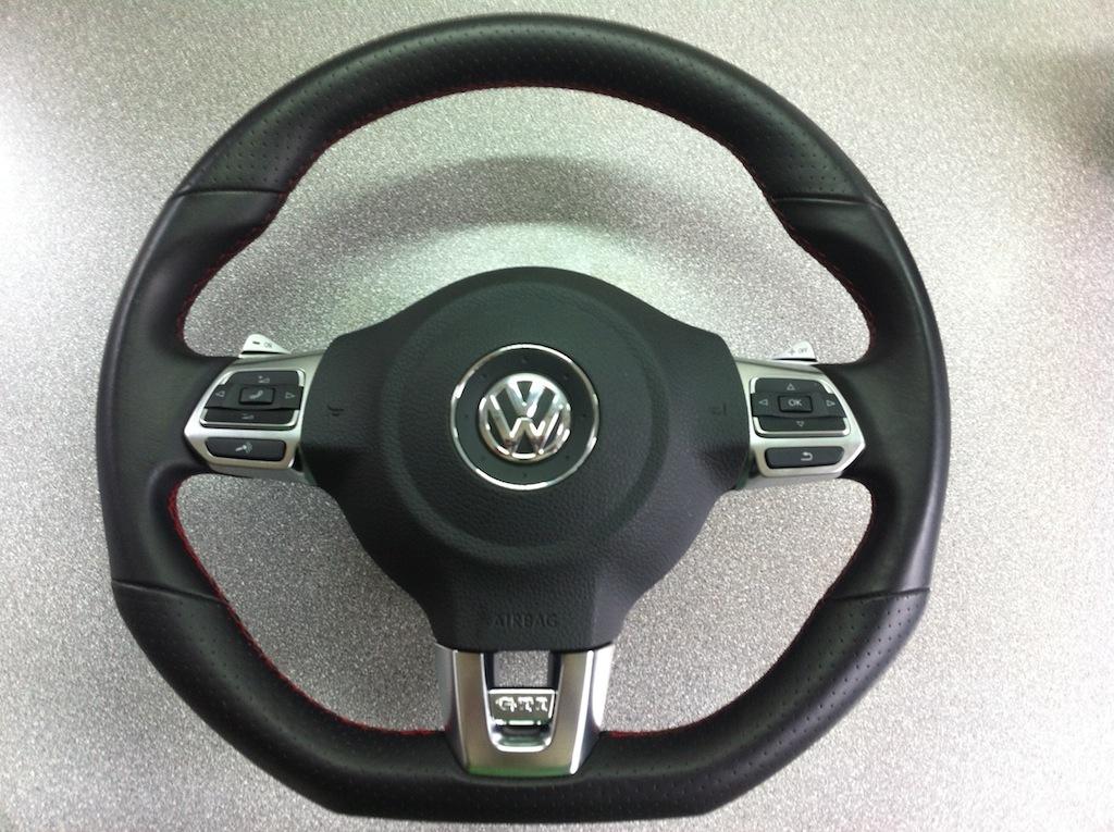

The the MK6 wheel before the OSIR paddles

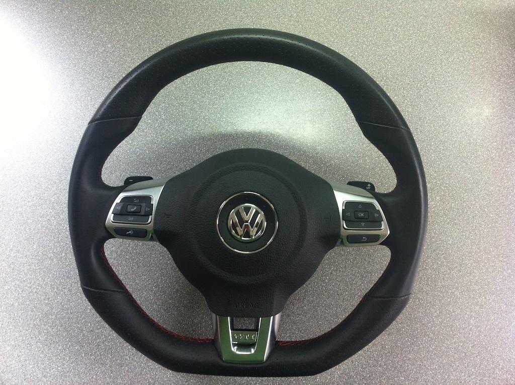

And with the OSIR paddles

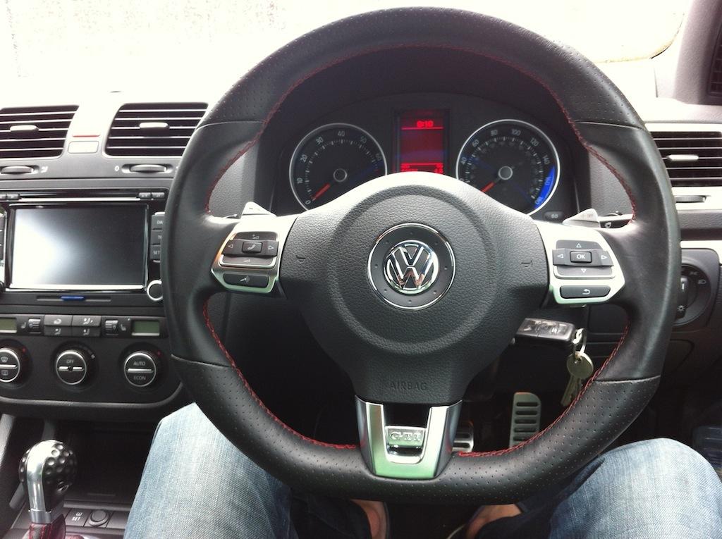

And fitted
Annoyingly the Mk5 dsg paddge and the Mk6 dsg paddle are a different part as they plug into a different location so I had to strip the mk5 one down to get my OSIR paddles off it and fit to the mk6 bits rather than just swap the whole module over as I was hoping to do.

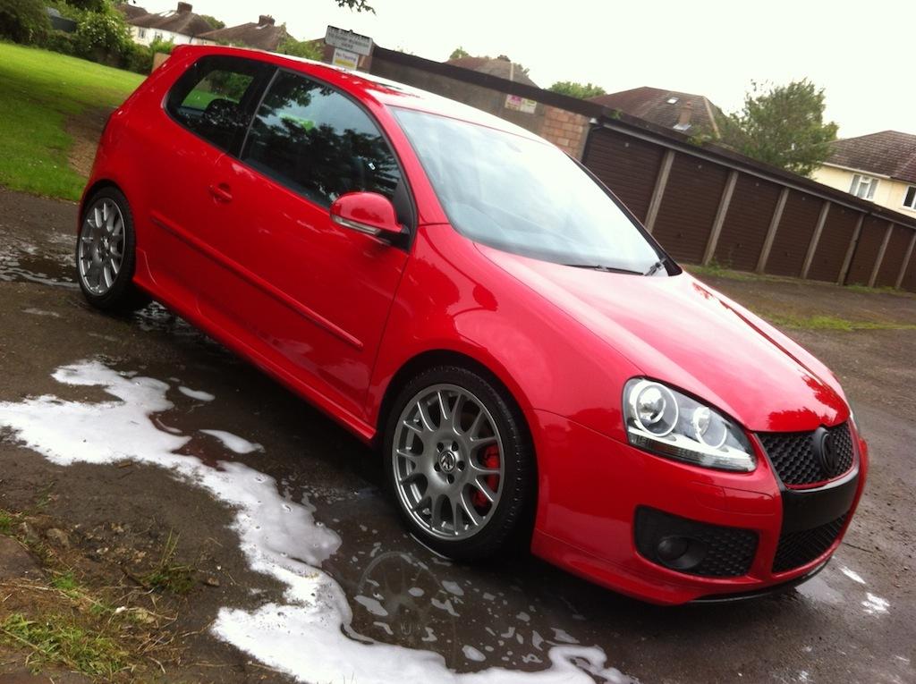

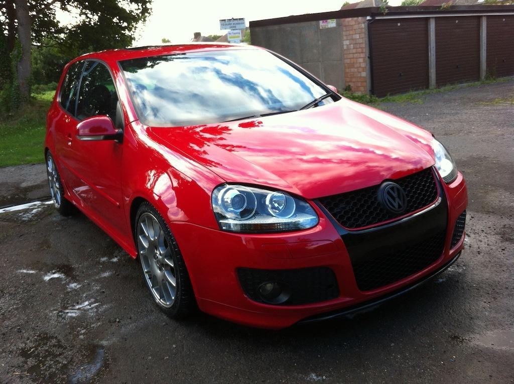

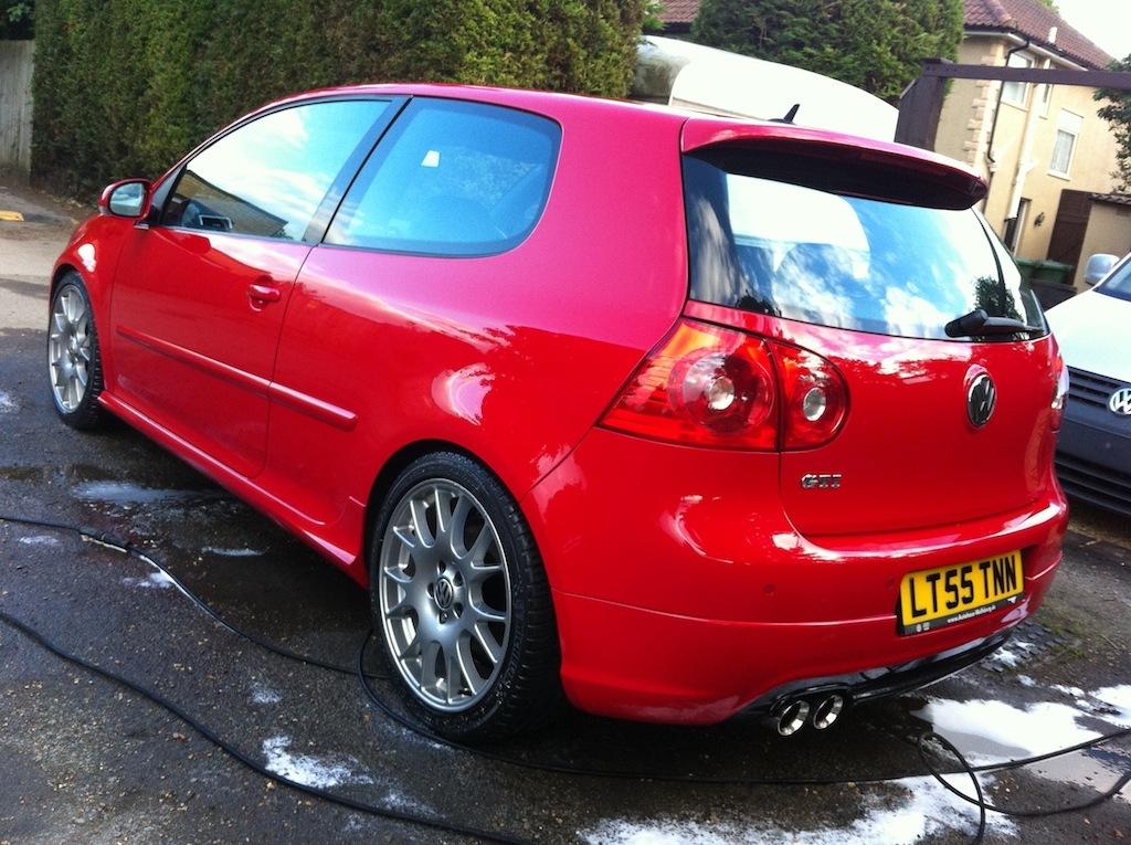

Thats all the little updates for now though.. a couple of shots freshly washed..
With thanks to APS and R-Tech

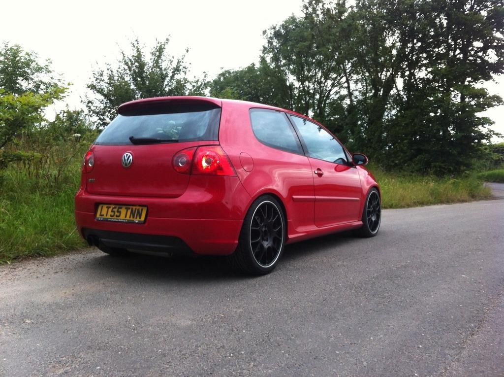

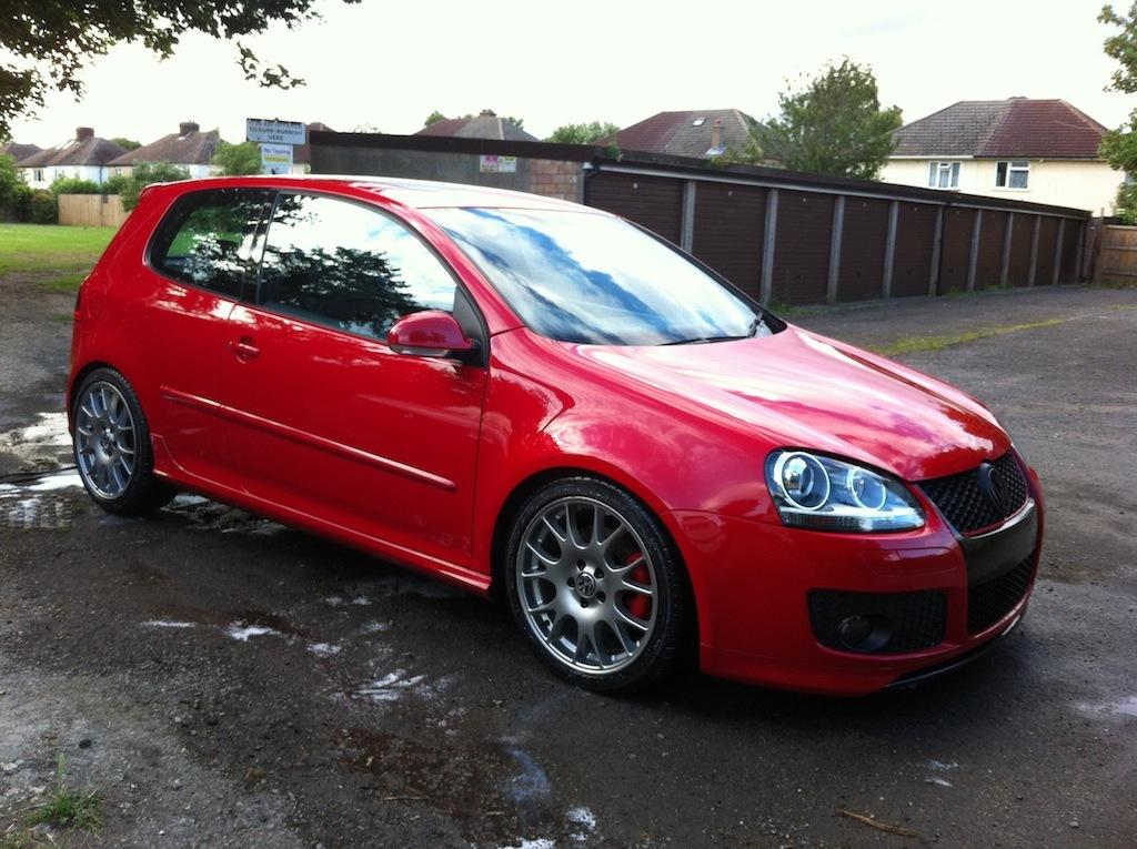

Test fitted my BBS CH026 tonight. 19x8j et50 with 235/35/19.
before
after
I like them but will pretty much definitely get them painted in the same colour as the ed30 wheels. Id also go for 225/35/19 goodyear f1s
Opinions? Not sure whether to keep them or just refurb them and sell them on and go back to the 18s
