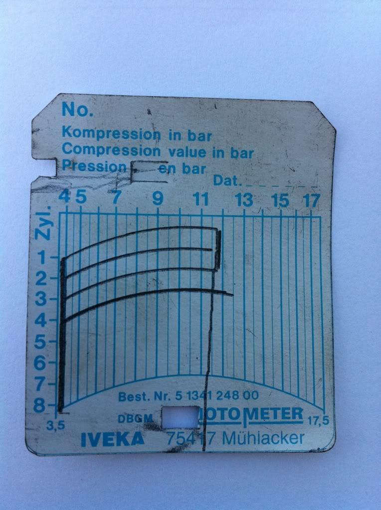

Have you done a compression test mike?
This does sound like your looking at a mechanical failure rather then a electrical issue, when you remove your dipstick with no difference in engine idle is most concerning , and the pcv is one thing to do before getting out the compression tester IMO.
However, PDT Dave was asking Robdf2 about the extent of testing and it seems for a propper result the compression testing needs to be more in depth.
I dont know to what extent the above test was done, only know it only took them 30 - 40 mins...
