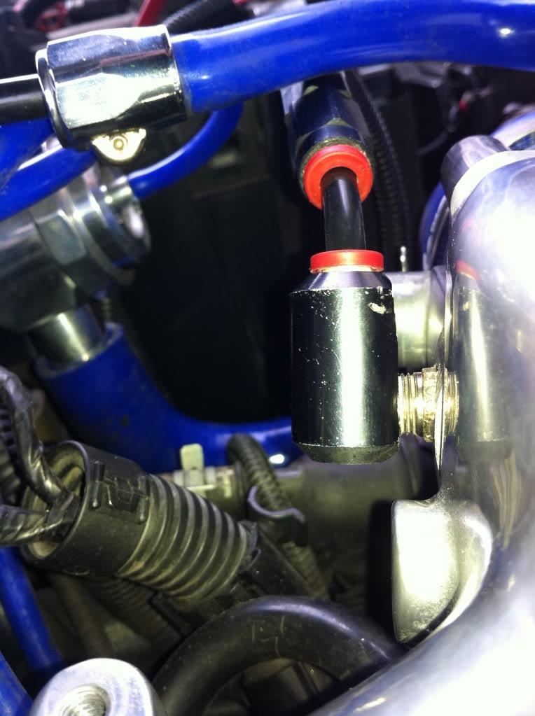

John, alot of the 1.8T guys with WMI fit a spacer plate between the throttle body and inlet mani to fit the injector nozzle. There has been a good few cases of guys killing throttle bodys due to meth ingress...
Edit: you can see the spacer in this pic..
« Last Edit: January 11, 2012, 06:13:49 pm by damoegan »

The 1.4 is a bit back to front compared with the 2.0TFSI. The throttle vales is up against the bulkead and space is very tight there. The throttle valve inlet has a different lead into it too which doesn't lend itself to fitting a spacer. This is why we decided on the stainless insert. It does the same as the spacer, but is incorporated into the silicone pipework to give the injector thread something to locate into, rather than having internal nuts and washers that may blow out or come loose and get sucked into the inlet.
No worries John. Just thought it might be of use to you  :happy2:
