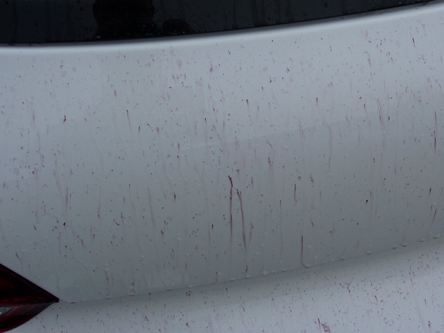

It was evident at this point, that the paintwork was LITTERED with small iron particles, orange in colour.
I had Autobrite's Purple Rain in my collection, so I began using this and working my way around the car.
It's quite slow to begin working, but when it does, the results look good:
P1040052 by RussZS, on Flickr
We decided to do a 50/50 between Iron X (right side) and Purple Rain (left side)
Quite a difference here:
P1040046 by RussZS, on Flickr
Iron X side:
P1040047 by RussZS, on Flickr
Purple Rain side:
P1040048 by RussZS, on Flickr
This pic was taken after a 7 minute dwell time.
I personally much prefer the watery consistency of IronX, as you seem to use much less product, and I like the way it runs down the paint.  Also, it reacts far more quickly than Purple Rain.
As a further test, we re-treated the boot to Iron-X, after leaving Purple Rain to react for 15 minutes or so.
Particles visible after Purple Rain, and tbf those lumps would have needed a couple of applications of any product!
P1040053 by RussZS, on Flickr
Iron X after PR:
P1040057 by RussZS, on Flickr
P1040058 by RussZS, on Flickr
P1040059 by RussZS, on Flickr
P1040060 by RussZS, on Flickr
That's quite some reaction!  Much more of the iron was released from this second application, although the car probably needed another 'hit', but we decided to remove what was left with clay.
For me, after seeing this comparison, I would probably favour Iron-X from now on, despite the apparent higher purhcase price, I like the way it reacts quite quickly, and it seems more concentrated and allows better coverage due to its non clingy consistency.  We used maybe 5-10ml on the doors and boot, but I used a good 250ml of Purple Rain on the rest of car!

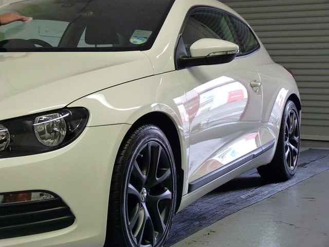

and the afters....
P1040074 by RussZS, on Flickr
P1040075 by RussZS, on Flickr
P1040082 by RussZS, on Flickr
P1040083 by RussZS, on Flickr
P1040084 by RussZS, on Flickr
P1040085 by RussZS, on Flickr

Big, big thanks to Russ for this the car looks amazing now - cleaner than when I first picked it up!
Managed to grab a few pictures the afternoon showing off Russ's fantastic work:-
Deacon
