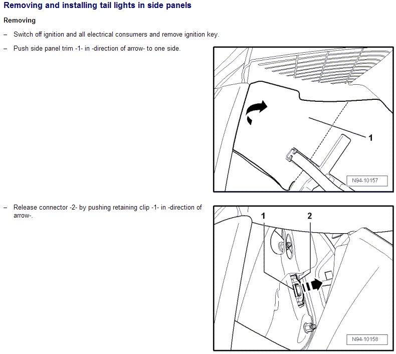

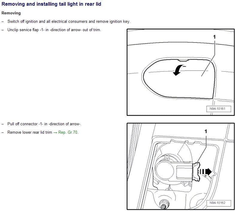

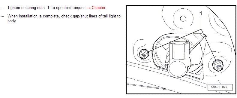

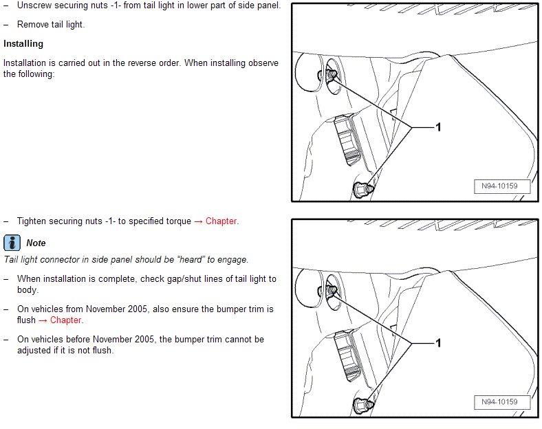

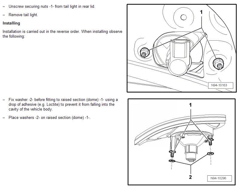

here we go

can you tap the threads from the inside ?

Newey are you saying you have removed the nuts but the unit wont pop out  :smiley:

all sorted now thanks for the help. the trouble i had was removing the boot trim. the one clip just wasnt going to play ball. so i got my dad down to help. me and i just managed to get a spanner in. :)

The inner parts of the lights are a right pain in the arse to do but i never took the whole cover off just pulled cover down as much as poss to get spanner in!!!
