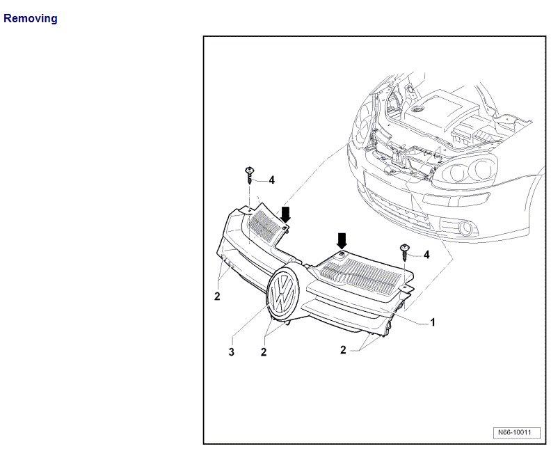

you dont need to remove the bumper to change the lights.remove the grill to get to the top 2 screws then remove the bumper inserts below the lights to get to the torx screw underneath,theres even a cut out under the inserts for your screwdriver to line up with the bottom screws
