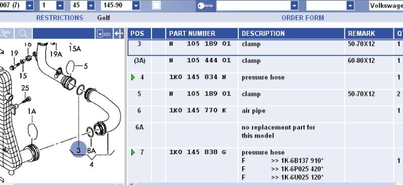

Drivers side pic.

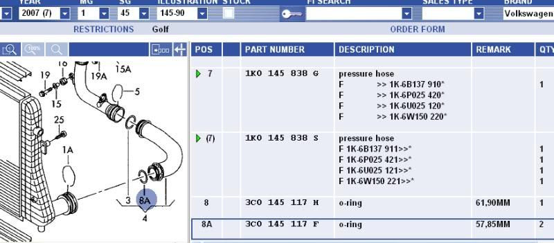

8A (x2) is specified for the Pass side hose.
Don't be fooled by number 3.  It is a Clamp.

make sure you do get the coreect oring because either end of that pipe are different sizes , i have no idea why they didnt make the o rings a standard size  :stupid:
