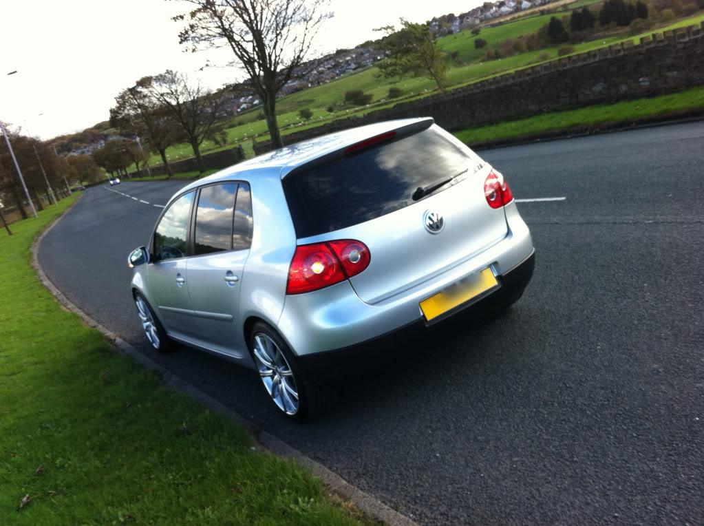

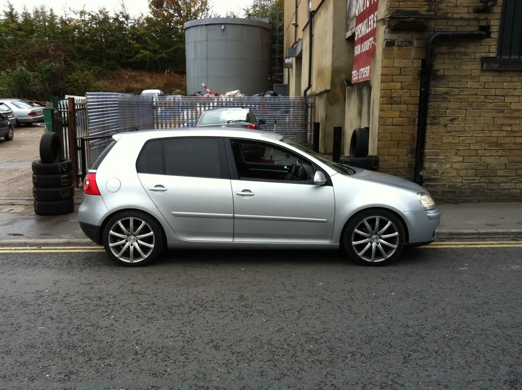

« Reply #6 on: October 31, 2011, 08:06:17 pm »
These are the best pictures i have so far, i'll take some more clear ones tomorrow. For the size of the wheels i am running 18's.. this scraping is getting hard to live with tbh  :sad1: Bare in mind the last picture is parked on the slight lift on the path on the passenger side but only small as you can see..

what's scraping mate the wheels? Are they the correct offset? You're car doesn't look that low that it would make contact with the road....
