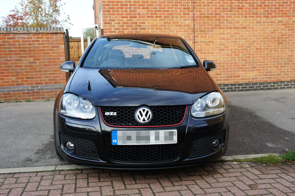

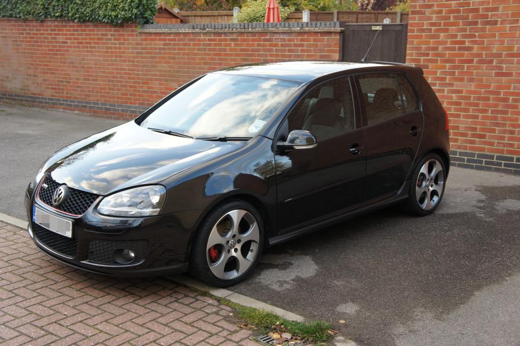

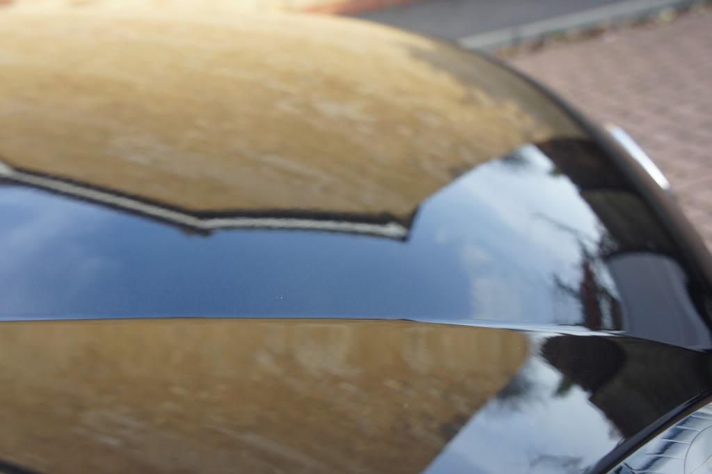

anyhow here are some pics of GTI
really great paintwork:
The spec:
The usual GTI kit
6 speed manual
Leather
MFD3 coming soon rocking the rcd 300 at the mo and I hate it to be honest as I dont listen to standard audio CDS.

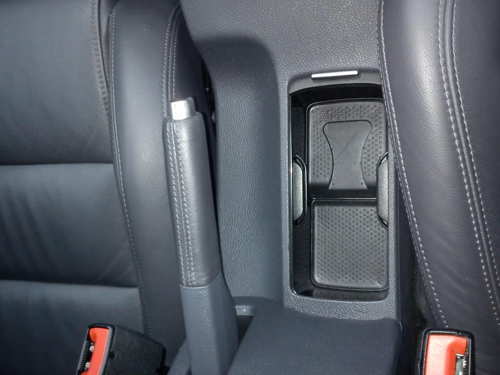

Another thing I noticed I dont have a cup holder its more like large space to put change in, is it missing a bottle opener? if so where can I get one, seems a bit of an odd design really, how often do people drink old fashioned coke bottles in their car.
Offline Gene Hunt
  • -Given: 59
  • -Receive: 61
  • Posts: 2478
Re: Just bought a 56 reg 19,000 mile GTI need some advice.
« Reply #10 on: November 04, 2011, 12:48:13 pm »

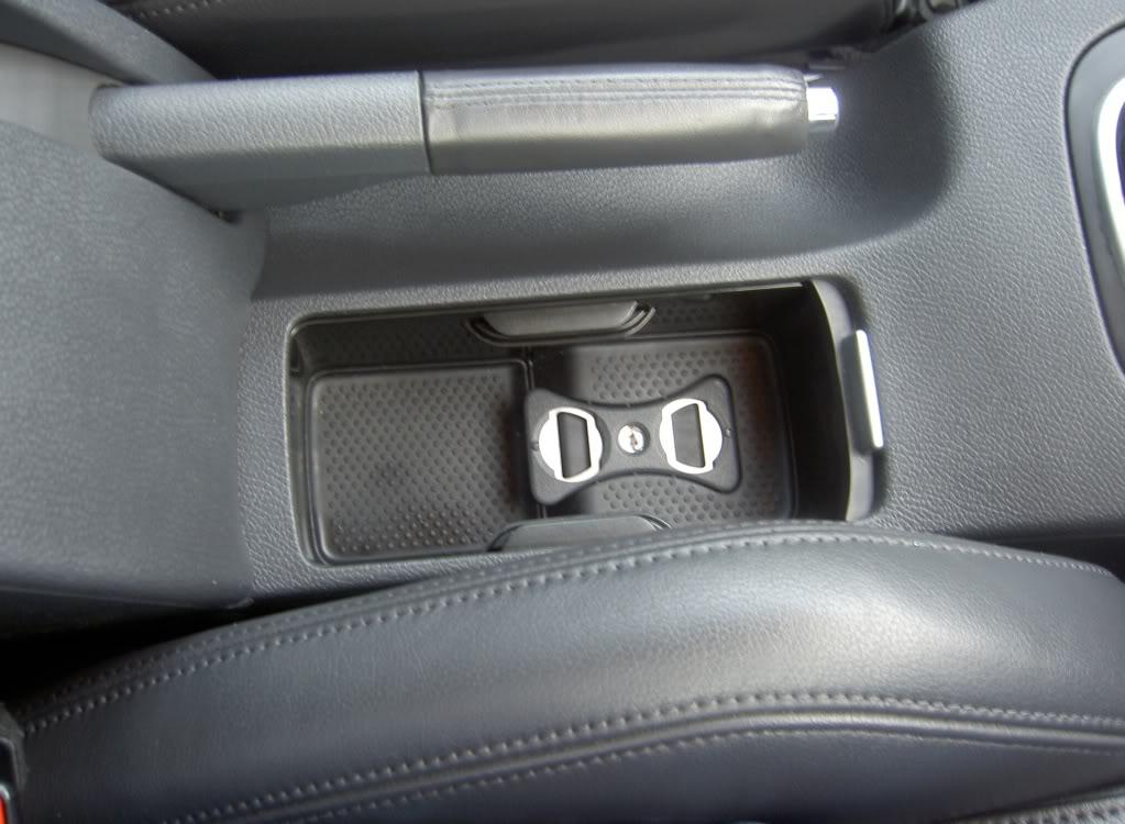

Car looks great. :happy2: Bottle opener is missing mate.Just sold one to a member on here but i think i may have another one if you want one?.
Offline peter215
  • Posts: 21
« Reply #11 on: November 04, 2011, 02:07:57 pm »
Lovely looking car, my opener was missing also but its handy for bottle/can holder so picked one up

There is someone on ebay selling the earlier All alloy version of bottle openers, in my eyes they look better than the alloy and plastic versions, link below to the guy/girl i bought mine from at same price as listed (£12.99) ebay item number 250907418074.
I use the rear portion of the holder for drinks (McDons etc) although i usually have a bottle of water which fits nicely in side pocket and does not move round as much.
