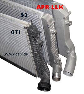

THS and APR are very very silimar in size, the THS having bigger core and smaller endtanks, Look at this and see for yourself why you should go THS  :wink:  :grin:
