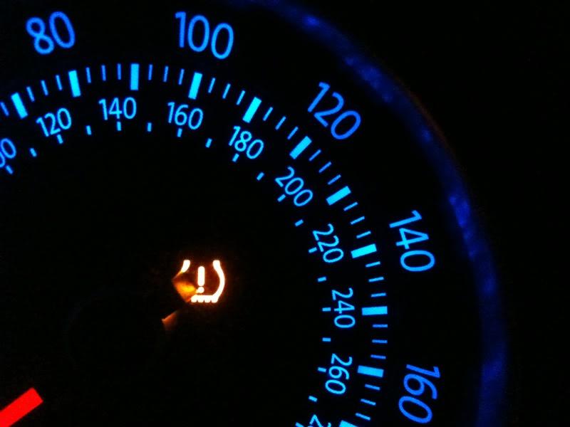

Lost my manual long time ago, can anyone tell me what this warning light is? its just came on yesterday when i was driving....thanks in adavance!

Its a tyre pressure warning
one or more of your tyres needs a top-up or you have a puncture. Once you have topped up the tyre, press and hold the button near the gearstick with the same symbol and the light will go out.

Legend, thank you....
do you know what pressure they should be set at?

Should say inside the fuel filler cap
