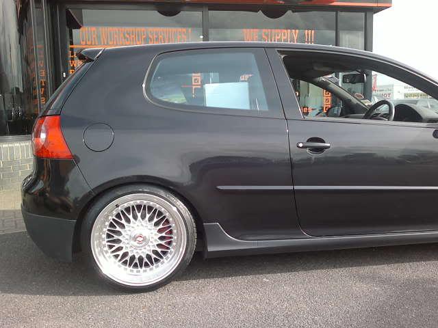

To give you some idea of how it'll look this is mine with 8/9 vintage wheels on
May be changing wheels tho  :wink: as i can't fit my R32 front brakes under them cos of the low 35 offset  :confused:

wouldnt the 35 offset be better for clearance, if you went higher the wheel would stick in more.
Love the look though, did they rub much?

« Reply #11 on: December 04, 2011, 10:45:26 pm »
Running 215 tires all round with a 40mm drop and no rubbing at all, only the worst speed humps catch the plastic/metal undertray wings and when cornering hard a bit of arch rub but got ARB's on the way to help a bit with that  :happy2: Only problem is with the offset being 35 it's too low to upgrade to the R32 brakes i've just got which need atleast 45 or above for clearance of the caliper  :sad1:

Was told its the opposite and that the bigger the offset the more room between the wheel face and calipers which would make sense as the standard 17" monza's fit over the R32 brakes and they have an offset of around 51  :laugh: but yeah the deep dish design makes it worse as the spokes curve in the closer you get to the rim
