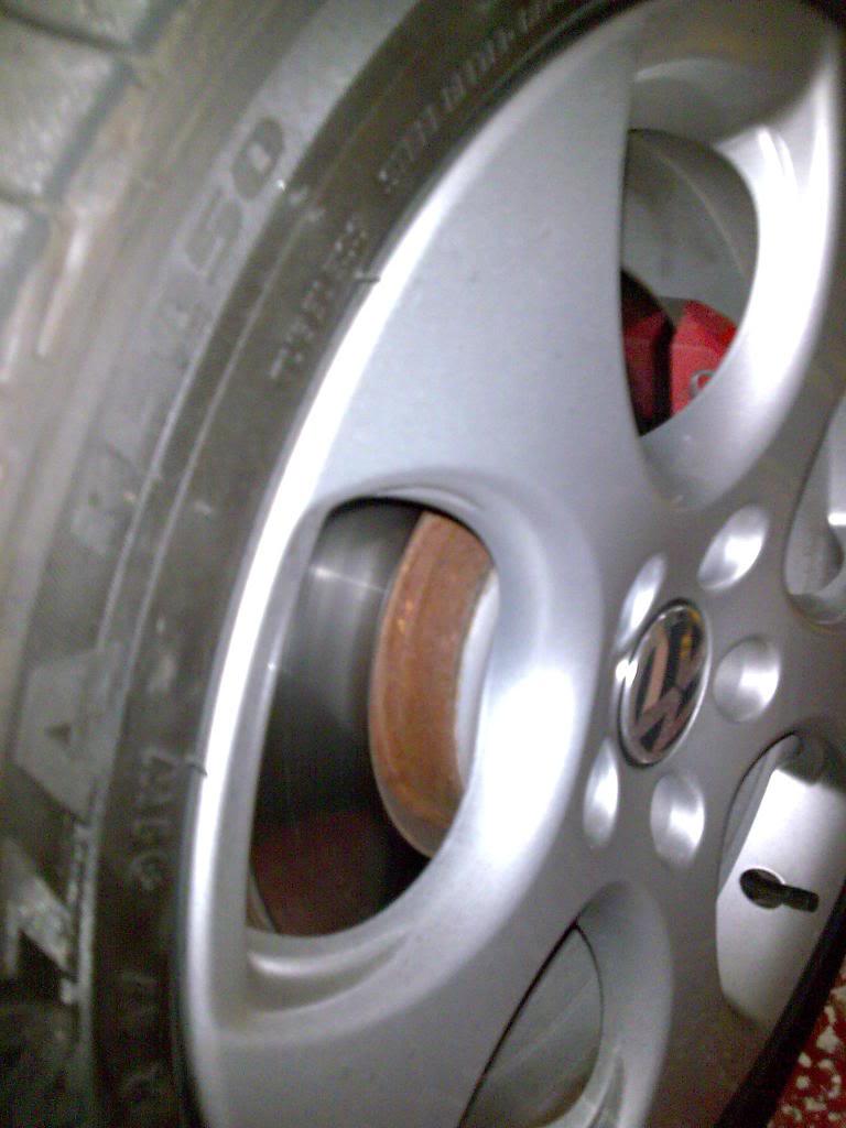

Right this has been annoying me for some time so decided to do something about it.[/img]
As you can see the rust has gotten out of hand. I hate getting my car looking good and then seeing this. The car is less than a year old and the stealer was less than sympathetic about it. All new cars rust, my arse!

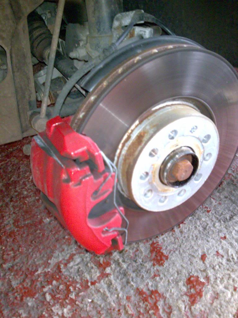

So took wheel off and set to with a fine wire brush and some fine grade sand paper.[/img]

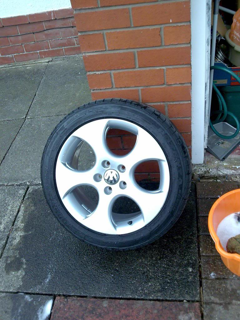

Good chance to give the alloys a decent wash

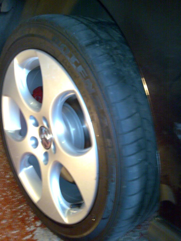

[/img]

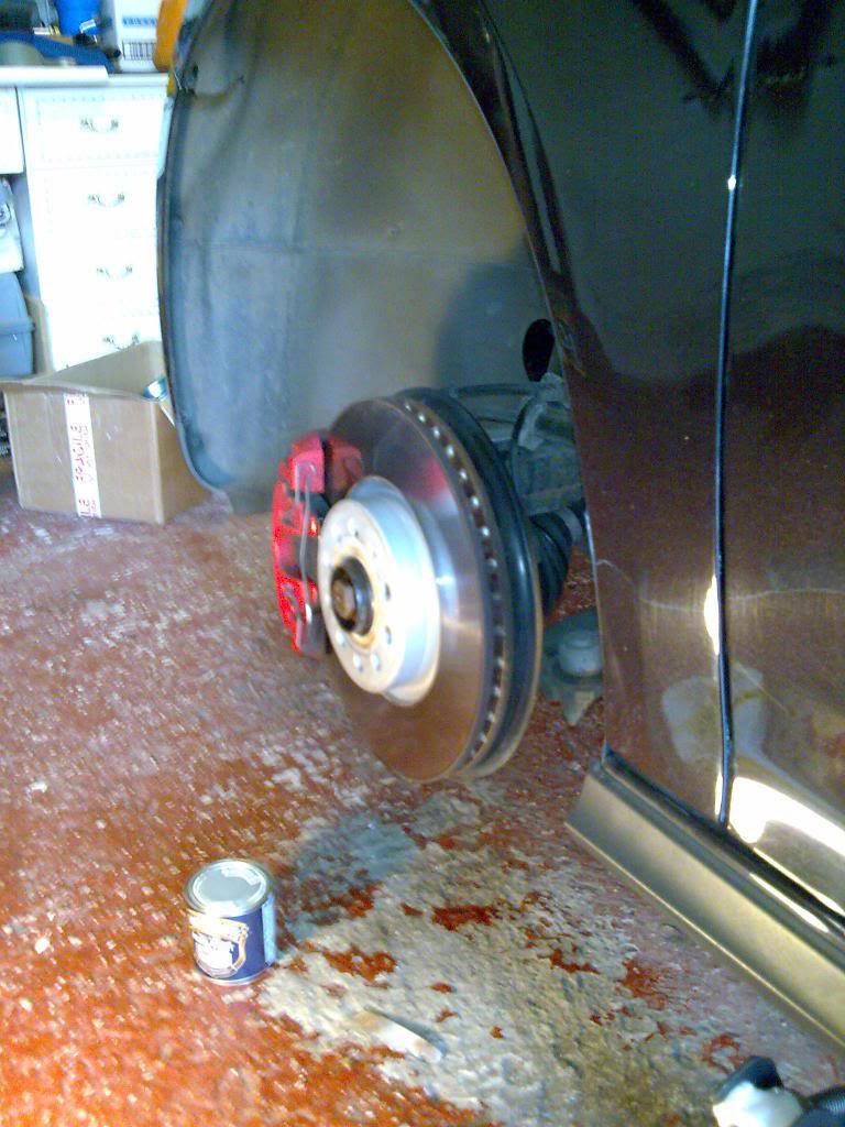

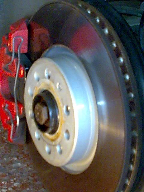

This worked really well. Next i painted it with hammerite metal silver paint. The colour match is really good with the monzas
[/img]
[/img]
[/img]
All in all an easy job and really happy with the results
