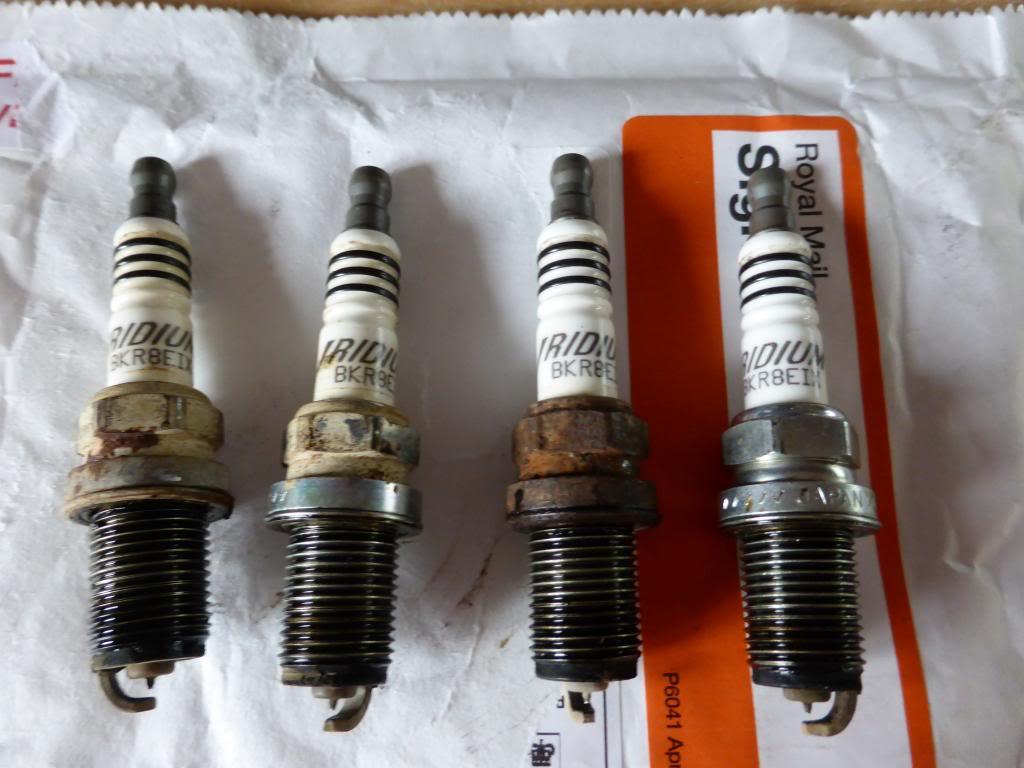

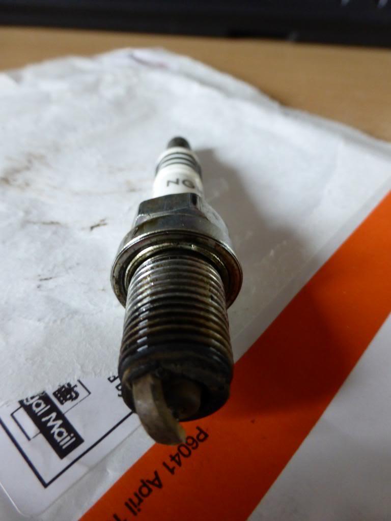

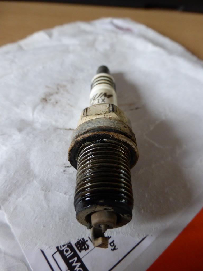

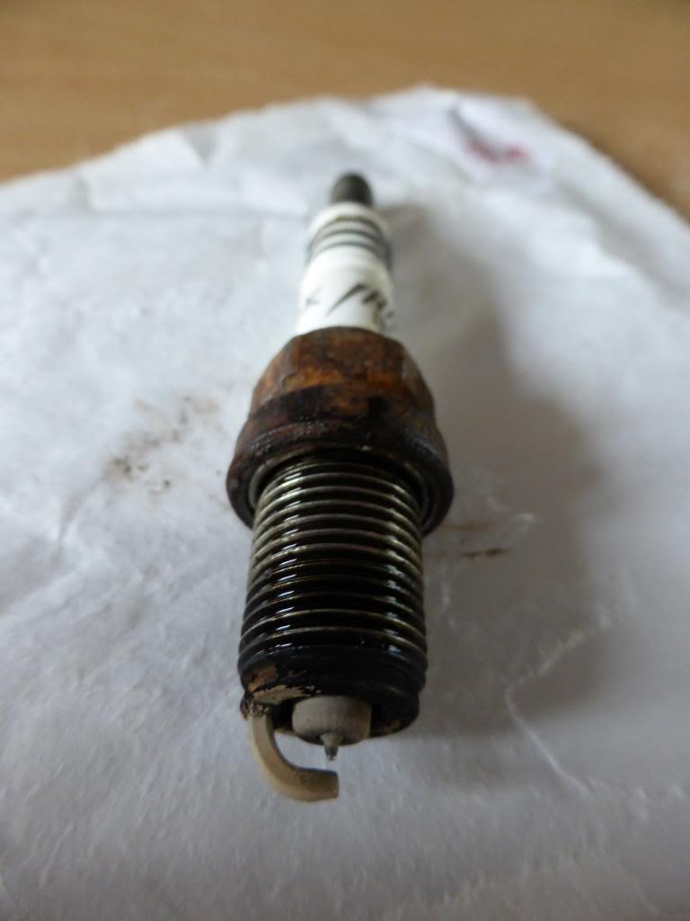

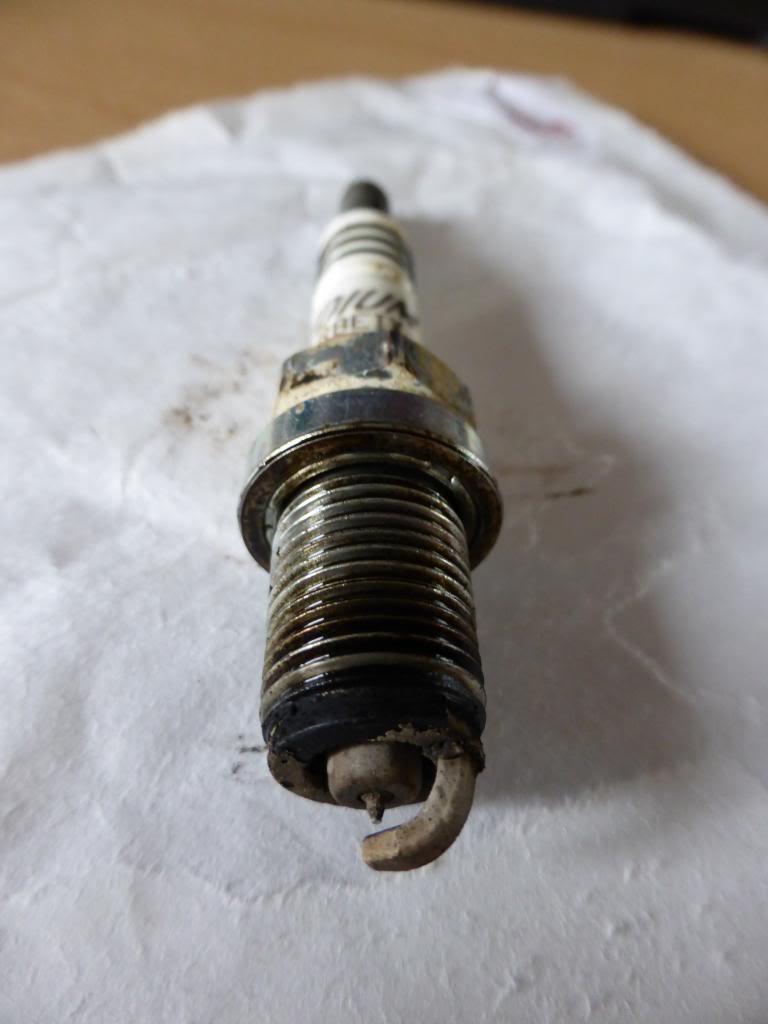

1 year and 4000 miles

Definetly carbon build up, but what has happened to the plug in the first pic. Perhaps some water getting in? I know another Cupra owner who had the same issue of water getting in.

There in a rite state for 1 year and 4000 miles , I've had mine in 2 years and done 9000 miles and they look mint

I'd be concerned about that rusty plug. Water getting into the plug bores is responsible for the engine fires I hear about. :/

they were in a hell of a state like,i think the water on the plugs etc was more down to me cleaning the engine bay,went abit mad with the degreaser and hose lol
good heads up on the misfire though m8 cheers

do you run without an engine cover? one of the centre cylinders (2 or 3, can't remember which) can accumulate water which soaks into the liner on the bonnet and drips into that cylinder if you run with the engine cover off. That might explain the rusty plug.
Since I wrote this review, I had the NGKs swapped for Nologys on vRSAlex's advice. He has since withdrawn this advice and fitted NGK 7s to my car. I can feel no perceivable difference between the 3, and my plugs looked nothing like yours after considerably longer use.
