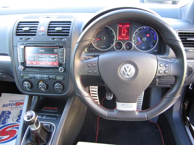

Im after a bit of help please. I currently have this set up
But i would like this set up.
I know a little bit about the rcd510 and can gateway but i would like to know how easy it is to get the digital climate control and which dials are best and if i can use full multi function display even though i currently only have half ?

Its not gonna be easy. You'll need to retro fit all of the  motorised flaps for heat control and air flow. Its far from impossible, and also far from easy!

Oh its all motorised is it ? I thought it might of just been a straight swap or something. Do you need vagcom to do it because that is one thing i cant get hold of

Possibly. But i thing vagcom will be the least of you problems. This will literally be a dash out Job.

I know, i would love them. So i need the dials, new vents, new surround, electrical work ? So dash out and hooking up to vagcom? And the rest ?
Rcd510 - i need a can gateway and then its a straight swap ? With no hookup ?
Dials ? Do i need vagcom for the full digi screen ?

To do the climate control retro fit you need a donor car to strip all the bits from including sections of wiring loom/dash surrounds ect. It's possible and has been done but not for the faint hearted.
Highline display can be done easily if your car is pre late 2005 but you'll still need someone with K+ CAN commander and a new highline display of the correct vintage. If your car is later then its much more complicated as it needs specialist software but I know of a man who can...
For a new generation radio/sat nav you'll need a post 'K' gateway which will need to be coded with VAG COM to stop battery drain.
« Last Edit: December 08, 2011, 11:58:54 pm by apollo13 »
