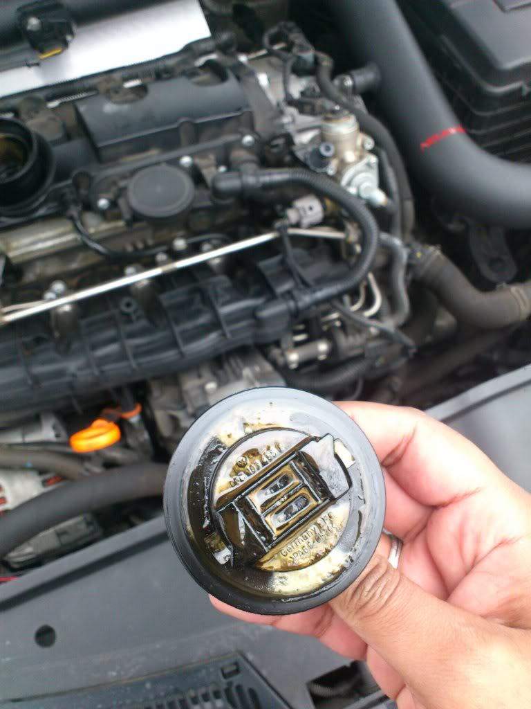

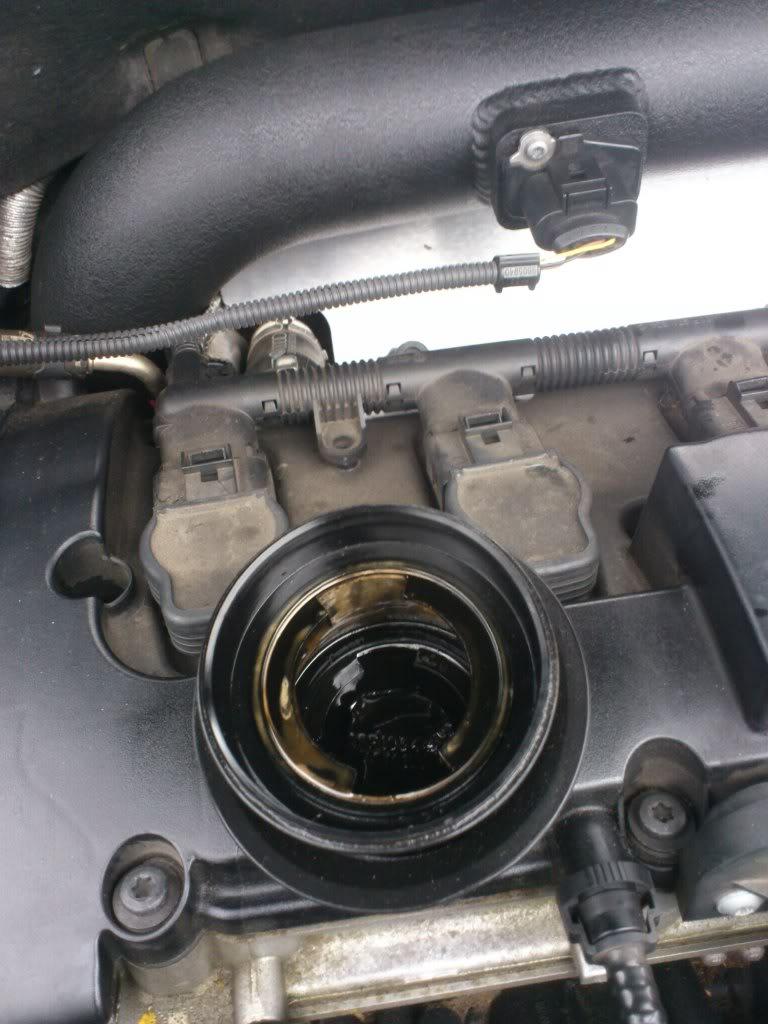

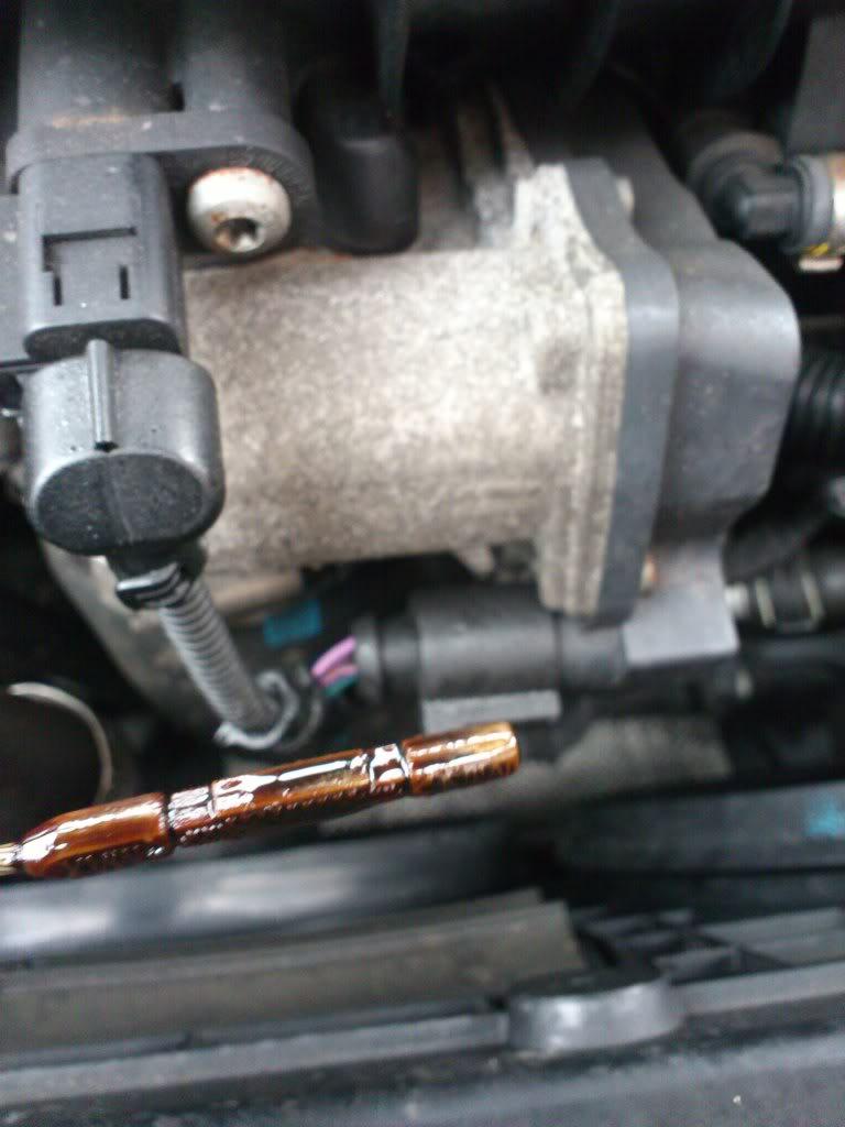

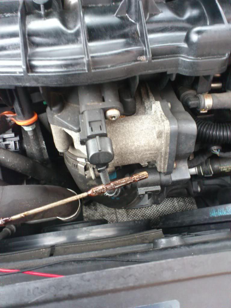

Offline bulak
  • Posts: 98
Re: mayo under my oil cap now in dipstick
« Reply #10 on: December 21, 2011, 10:55:55 pm »
heres some pics
oil cap
dipstick very hard to get the pics my camera is not that good as its only a small amount
Offline Dario
  • Posts: 261
  • booosting... :)
« Reply #11 on: December 22, 2011, 03:20:31 am »
looks OK ,give it a longer trip ,and it will go away

Offline Coe
  • Posts: 97
« Reply #13 on: December 22, 2011, 05:17:03 pm »
In answer to your question. It'll be fine. Don't bother changing your oil just because of the condensation. It'll only happen again with the new stuff. It'll disappear after you use the car more or the weather warms up etc. Looking at your pics it's not that bad at all. My mk4 Gti was terrible for it in winter.
Offline tony_danza
  • -Receive: 112
  • Posts: 3013
« Reply #14 on: December 22, 2011, 05:34:25 pm »
That's nothing, go on a log run and get it good and hot - all that will evaporate away.
