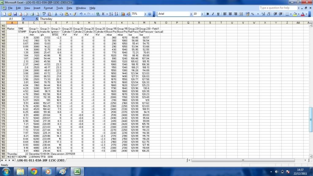

Hi all,
After gone and had Revo stage 2 installed the settings were applied as B9 T6 F7.
These are the logs i just came back with and should i be worried as i see -0.8 timing being pulled back.

« Reply #1 on: December 22, 2011, 03:00:17 pm »
Your CFs look fine but you have a fuel cut mid range!  :scared:
Do you have an uprated hpfp? I would turn down the boost and check your cam follower asap.

« Reply #3 on: December 22, 2011, 03:22:43 pm »
deffo fuel rail issue, i wouldnt be worried about timing pull at all mate
i feel once the new pumps on it will be fine, not a hard job to do youself at all 30mins-1 hour tops

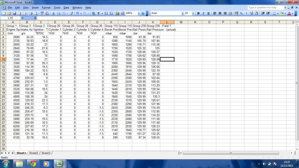

« Reply #5 on: December 22, 2011, 03:38:52 pm »
Set fuel to 9. The timing pull is ine, nice low figures.

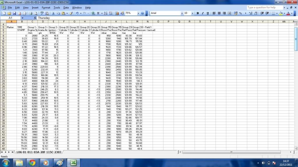

« Reply #6 on: December 22, 2011, 03:38:59 pm »
1 of my first runs, the other 2 were just after this log.

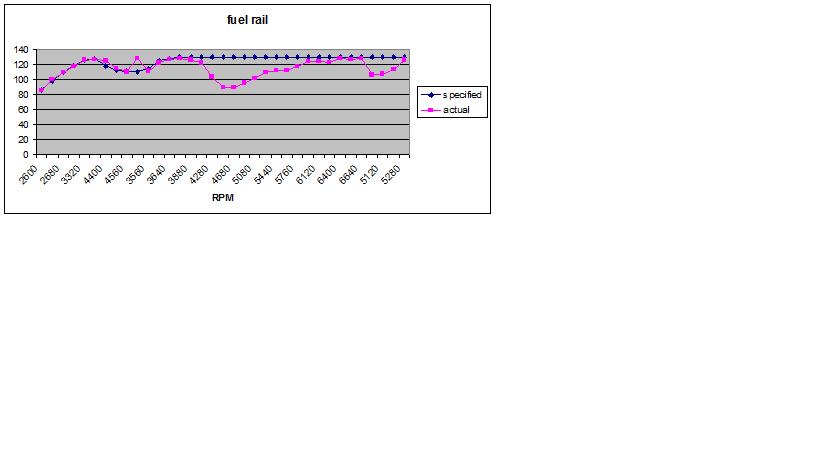

« Reply #10 on: December 22, 2011, 09:35:38 pm »
Do Revo stage 2 maps request 129.9 bar? Most stage 2 maps request 109.9 don't they?

The JKM K04 Stage 2 package is for owners of 2.0 TFSI engines who want the ultimate tuning package for their K04 TFSI engine. This package utilises market leading REVO Stage 2 software and when combined with the hardware in this package it will enable the K04 turbo to flow enough air to produce maximum engine torque & power.
Please note that Revo K04 Stage 2 software requests 129.99Bar fuel pressure as per a K03 stage2+ file.
If requested, Revo K04 Stage 2+ software can be added to this package at an extra £50+vat - contact JKM.
Sorry for another question guys..... Because the pump cant keep up, how dangerous is this for the engine ?
