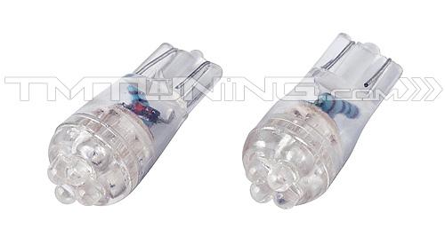

Another TM Tuning special here Im afraid!
Ordered these thinking they had built in resistors, turn out they come on then switch straight off again as the 'Bulb out' feature cuts the power as it thinks the bulb has blown!  :signIWS:
As expected TM Tuning don't want to know and said I should have e-mailed them and asked the question. When I pointed out it was there responsibility to make this clear in the ad they didn't reply?  :angry015:
Anyway, anyone have any ideas as to how I can make these work as sidelights?  :chicken: Cheers  :happy2:

You will need a resistor in line to get around the "bulb out" error which either means cutting wires and soldering one in or buying extra connectors and making up a little loom.

Yeah very annoying! I remember when i was replacing my rear numberplate bulbs with the LED's. I replaced one, and it worked so I was really chuffed!! Then when i put the other one in, they just turned off almost immediately! Little did I know that 1 normal bulb with 1 LED draws enough current for the car to think that both are working!

Ive read somewhere that if you wire in another set (IE, your standard bulb) and either cover them in tape or tuck them away, then put the LEDs in,
then the current still passes through and doesnt throw up the 'bulb out'

what i did was solder 2 wires behind the original sidelights ( + and  -) and got another sidelight holder.. whacked them in to holes i drilled in the headlights and voila. i suppose the same could be acchieved if you replace the orignal with the 2nd ones
