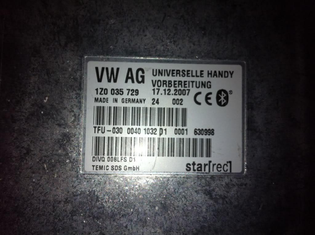

Hi everyone am in process of fitting an OEM BLUETOOTH KIT to my golf to work alongside my RNS 510!
I have got all the bits to include:
module
Microphone
And wiring harness
The problem I have is my wiring harness has 4 wires which are loose without a connector please see pictures.
These wires being:
Earth
Live
Can high
Can low
What I wanted to know was where I can buy a new harness from or a harness to join to these wires as i dont like to chop and tap into the original loom.
Basically I want to make mine plug and play.
Many thanks

Either car systems on ebay for a new loom, or take a look at http://octavia-vrs.com/cms/content/integrated-bluetooth for the bluetooth fitting guide, this shows how the original looms like you have there can be made plug and play "ish" with some repair wires.

^^ Yes, take a look at the octavia site I linked, it lists the VW parts numbers for making your own connectors and joining these to the required wires on the back of the radio. You will need a pin removal tool for the quadlock on the back of the radio but it will be plug and play.

all you'd need is a bog-standard 'extension' cable for the quadlock connector which goes into the back of your HU
the brown wire is a ground, red/white is positive feed
can/low, can/high are what they say they are - pay attention to these however, they are twisted in a particular manner to reduce interference - something like one twist every 20mm or something (the exact specification is on my-gti.com) and away you go....
i've got genuine VW CAN bus repair wire about 9metres of it and one of these extension cables spare if your interested
