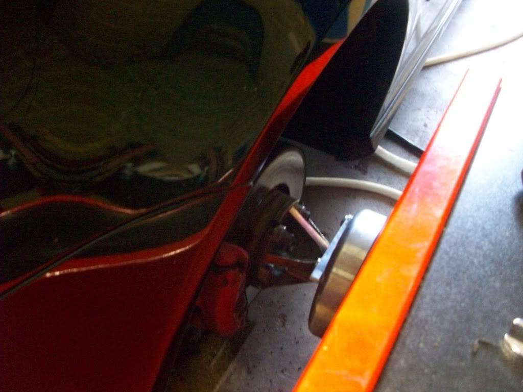

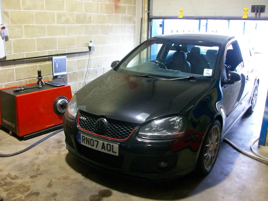

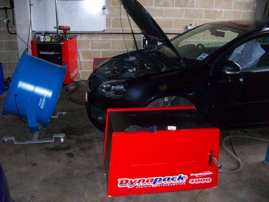

So i showed up at Wills unit on wed 21st dec and got staright down to it! Got the car up in the air, wheels off and bolted to the hub dyno! Now i was happy to hear the car was gonna be set up on a dyno( rather than used some lad and a laptop uploading a file and ragging my car down some dual carriageway!) but even happier when i heard it was a hub dyno, these things are so accuarte!

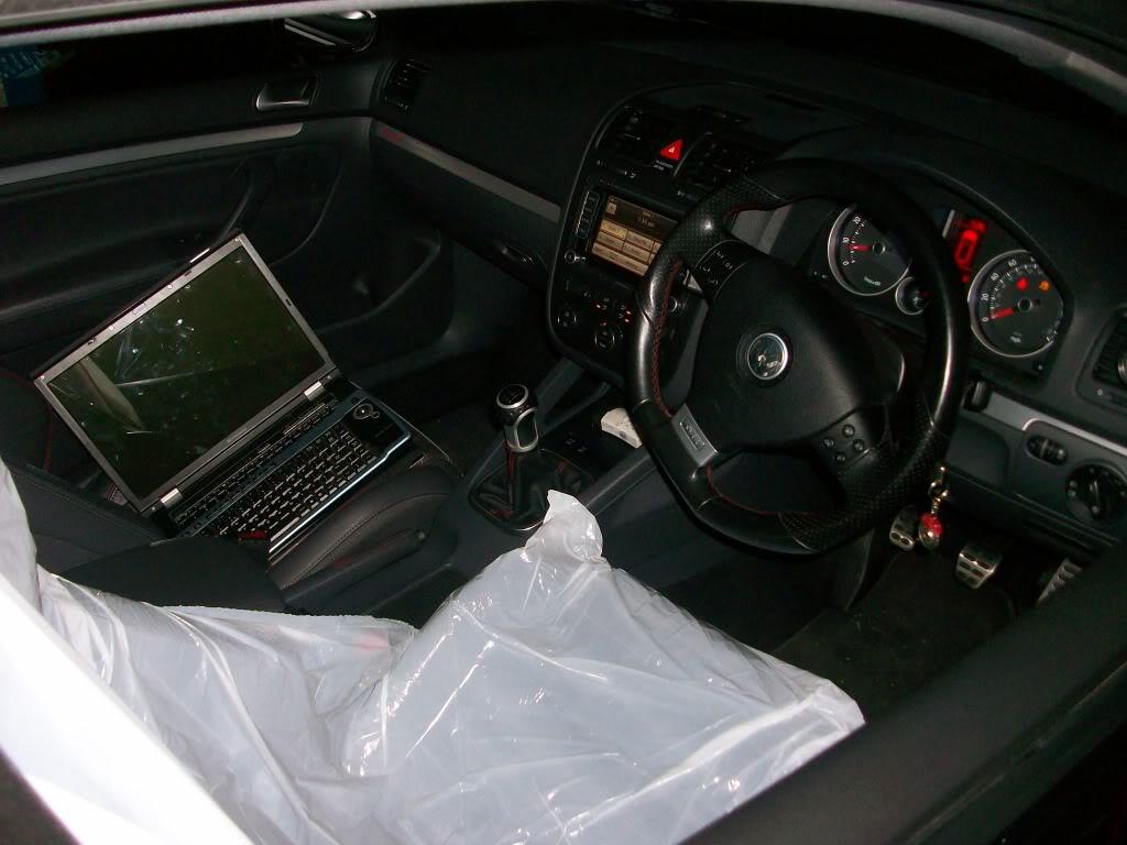

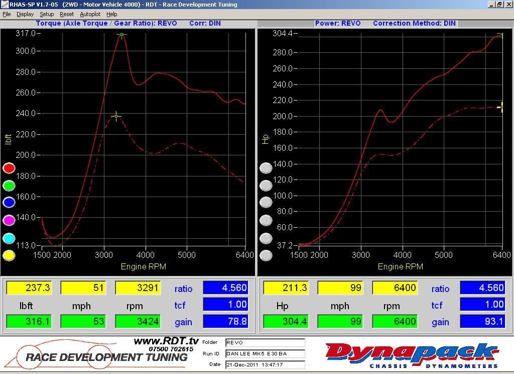

Will got to work on it and i watched the reults come in, below are the results i ended up with.
The car is an edition 30, neuspeed p-flo and tbe Vwracing exhaust with sports cat. and im on revo settings B6 T2 F8
There is a dip at 3500rpm that Will and I cant figure out and hes asking revo about. Im not sure what it is to be fair? we tried having a look and tweaking the figures on revo settings but nothing cahnged it, the car is manual so no dsg limitations? car has no boost leaks, not sure on clutch wear but it doesnt seem to slip on the road? cant of been wheelspin cause its bolted to the dyno via the hubs?

Uprated HPFP with the RS4 valve would help a lot.

Glad to see you're happy mate and you have made the right choice of mods too  :happy2: Timing is set very low and boost can normally be raised higher on most cars during the colder weather, but each car is different and it also depends on how you want the power delivered..

Nice to see Will still using the hub dyno :)
Timing is extremely low, did you do any road logging as well?

we didnt do any road logging but i took it for a good old drive and put it through its paces and that dip is definately not noticeable on the road!! this thing pulls like a train!
timing may be low but thats where no knock was detected, the timing did get put at 4 and made more torque and no extra power and started to introduce the slighest bit of knock at the top end. this is not something that i or will wanted so the timing was pulled back! this is not a track car and is a daily that i wanted safe for many years to come, ive had cars on the limilt of tuning before and its not what i wanted from the golf!
i understand revo suggest certain settings for different states of tune but my wants and my engine are different to others and the car is where i want it to be so in honesty im not fussed  :booty:
as for the curve and dip in power, this isnt the first graph ive seen like that and looking at my standard power it has the same dip as after revo! if i felt this on the road it would be a different matter but there is not hesitation or power loss!
