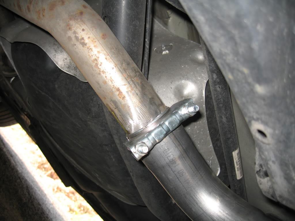

  Do  you  think  55mm  X  65mm  would be  better  for  the  sleeve sizing? :happy2:

« Reply #6 on: January 05, 2012, 06:26:03 pm »
That's the size I went for.  :happy2:

« Reply #7 on: January 05, 2012, 06:26:33 pm »
Not sure, pretty sure it was 55mm and ~64mm outside diameters of the piping I measured, the guy made up a sleeve that's a tad bigger inner diamater, but yeh 65mm would do too.
Offline sanj
  • -Given: 17
  • Posts: 589
Re: GTi back box on a GT TDI?
« Reply #8 on: January 05, 2012, 10:45:17 pm »
Here's a pic to my old GTTDI with the clamp used to fit the two end's together.
