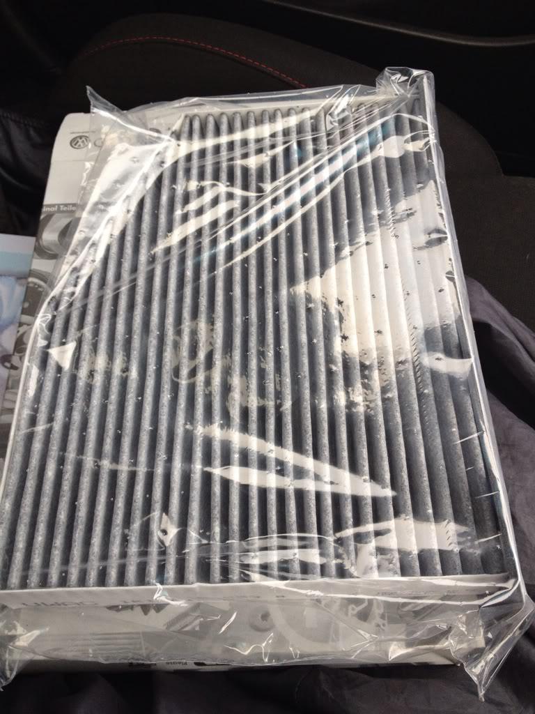

Just noticed - the part number in tfsi_mike's photo (1K1819653B) is for a left hand drive filter according to ETKA.
The RHD version part number is: 1K2819653B. This is for the better activated charcoal version of the filter.
I've just found this on ebay, an Audi main dealer in belfast offering the charcoal version for £10 inc. postage! So nearly a fiver cheaper than getting it from your local main dealer! (ETKA price is approx £14.50)
